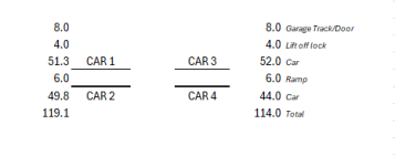

Check me on (a) my math and (b) my anxiety:
I am planning a detached garage build with 10' ceilings. Based on my calc below, this just barely fits. I do have 8 inches for garage door and track (which can be slimmed down). Is there anything I am missing or not thinking about? Am I going to be nervous every time I lift my car up? How tight can the garage door be to the ceiling?
The one thing I don't have in my calculation is where the locks on the lift are--I haven't decided on lift. I know this changes the equation significantly. Is the answer to just build 10.5 ceilings?

I am coming down the home stretch on my "shop". I have 4-post lifts for seasonal vehicle storage. I purchased lifts which allow almost 7 feet of headroom beneath it. Nothing worse than having to duck when walking under it (I am just over 6' tall), or being bent over while doing an oil change. The height in your plan seems pretty tight- you haven't allowed for anything hanging down (lights, for example). I would think 11' ceilings would serve you better. Another consideration is the width of the lift. Parking your daily-driver below a lift, or more importantly, driving in and out between the posts is something to think about. Also, my doors are 9' x9'. I have side-mounted door openers as well, no overhead clutter.

Since you are building the garage, build it so it can fit a 4 post with a car on top and enough height underneath to walk. This will cost more but make the lift do much more useful unless your only use for it is to store a low car on top and a low car underneath.

Thanks! These are all considerations and I will be doing some maintenance routinely. These are toy cars and the daily will be parked in the house garage (actually more likely outside). My original plan was a metal building with 16' walls however, those plans have changed and the detached will need to be more in line with the new home build.
Based on needing 6' of head room (I am only 5'7) i would need 12' ceilings. (72+6+52+4+8 = 142)

Most of us with 4 post lifts used for service in home garages change the door lift to jackshaft so there is no chain and motor in the middle. The car obviously goes up between the door lift rails without issue. You just need a roughly 9x20 opening in the ceiling. I did this with my current 4 post and lost 1/3 of the upstairs space (giant platform up there now and I can put stuff on it). Sometimes this can be built into the rafter design and other times the walls need to being higher.
I had a 2 post with 10.5’ ceiling and could put my 1999 M3 in the air 6 feet. But with a 4 post you have the wheels on the runners and the runners are 4-6” tall so you need more height. You may be short but others in the garage may not be and whacking your head on a runner hurts. Same goes for 2 post lifts used arms, of course. But runners are much bigger and longer.

I have an 11' high ceiling, and it isn't enough even when I have my Corvir on the lift as high as I can go without hitting the ceiling. The space under the lift isn't enough to stand up comfortably. Reassess your height before it becomes an expensive mistake. I also have a 10' door to allow for anything that I might own in the future.

I'd go higher if at all possible, but keep in mind you only need that max height where the lifted car roof is. If your lift is 4 feet away from the door it might only be an issue for the first few feet of the vehicle where the hood (or deck lid, or truck bed) is.

If you are building a new building, make it tall enough from the start. I told my designer I wanted 15’ high ceilings in the 2 bays where vehicles would be. That was based on 7’ high for my F250 plus 7’ underneath for whatever vehicle I might park underneath, plus a 6” allowance for the lift cross beams and runways, plus 6” contingency. Tonight I’ll havetwo 80 inch tall vehicles stacked there.
We used scissor-type trusses with a lower chord, so the walls are only 11’ high, but there is ample depth at 15’ high to accomodate the two stacked vehicles. My garage doors are 9’ tall.

I concur with everyone else: address the ceiling height now, while you have the opportunity to. I'd suggest moving to 12' ceiling height.
For some perspective, this is a 12'7" ceiling, and the runways are raised such that there is 79" beneath them (storage height; working height would be lower). Give yourself some breathing room and bump that ceiling height up.

You need at least 12' ceilings and definitely a jackshaft opener with the door track as close to the ceiling as possible. Also an 8' door. This allows the lift to roll outside for cleaning and whatever. I just built a garage with 12' ceilings and love it. The pic below is sort of an optical illusion. I can go all the way up and still have another 18" before hitting the ceiling.

With a new build, you should go at least 12' 6" on ceiling height.
Search GJ for threads about lifts, you will find hundreds of posts from folks suffering with a 10' ceiling.

The one thing no one mentions is once the vehicle is on the lift and the locks - lock. You will need an additional 6 inches to lift the vehicle so you can lower the lift
Don't forget to take into consideration any ceiling lights into your height requirements.
My Bendpak needs maybe 2"... but yes, it's not zero.

I built my garage with scissor trusses, and have 9' walls (to match the house) and have 13' clear in the center to allow for a (future) lift. i have side lift openers and the doors follow the ceiling

You need to figure out how to get 12' of clearance, at least in the center by getting the framing done to help. I have 12'6" and an HD9. I am parking Mustangs and I probably have 12" to play with for clearance when I stack them.
