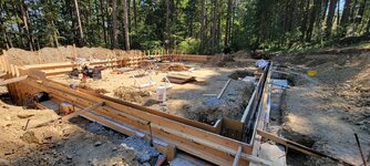

Well progress continues... it's been hot here lately, 32-35°C (90-95°F, which for my northern bones is too hot to do ANYTHING other than melt) but despite that I've pushed ahead with some things.
Finished underground electrical service (the last 6 feet), connected data conduit, painted foundation wall with asphalt membrane, and today was putting the perimeter drain in place. Fortunately for me I stockpiled some 4" PVC about 2-3 months ago, because it's really tough to find these days. Fittings, no problem. Pipe, no dice.
Foundation came out pretty well, though we do have a few issues to try to sift through. More on those as we come up with solutions.
Painting tar in the heat, fun fun.
And today's work.
Tomorrow is the rainwater leaders, geotextile and gravel work... Going to be another hot one!

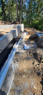

Another hot day, 10 hours or so in 32°C heat. At least for much of it I was down in a hole, or finding some shade. But some decent progress none the less.
Rainwater leaders, geotextile, gravel, and SOME backfill was the order of the day today. The foundation wall concrete is only 5 days since pour, so I haven't wanted to backfill the taller walls yet. Much less concern with the 18" tall walls on the west side though, so backfilled there today.
Rainwater leaders... I'm sure this could be done differently, better or more economically, but at some point you "run what you brung". The two outfall lines for the perimeter drains and rainwater leaders do need to connect and terminate in a nearby swale, but there is a lot of dirtwork necessary prior to that step. So I'm to the corner of the building ready once that work is completed.
Geo-textile is an optional step, but I felt worthwhile to keep the fine dust and dirt out of the gravel bed, and out of the pipes. I have a hillside next to me here, and water is a real concern. So in addition to the perimeter drains, I am planning another ditch, or french drain at the toe of the bank, to direct as much water as possible around the building before it even gets to the perimeter drain.
Moving mounds of dirt into the holes has suddenly made the site feel big again! only 1/2 done as of the end of the day today, but as I said the taller walls I want to give as much time to as I can. Likely much of that happens tomorrow. My focus will be on the geo-textile and gravel on the backside of the building, as well as the dirtwork there. That will leave the tall wall as the only thing remainging (to the left of the photo here). And the mounts of dirt more or less block my access to get gravel down so might be a lot more labour intensive (buckets)... we shall see.

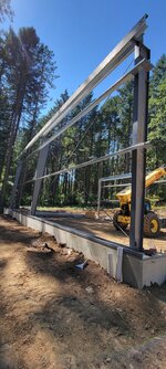

A busy week of progress. Passed my perimeter drain/RWL inspection first go, and the steel building folks showed up on Wednesday this week. Didn't take them long to make some really good progress - they expect the whole building to be up and done within about 3 weeks. Well "done" is a relative term - done for them. Then I get to work once again.
Fortunately the concrete work and anchors were in the right place!
First posts going up!
End of day 1... which was about 2 hours after unloading everything and getting sorted on site.
Midpoint on day 2.
By Day 3 we have almost all the structural members in place and they are starting to work on roof purlins. But that will have to wait until Monday to continue!

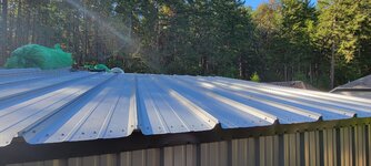

A bit more visible progress this week. Insulation and sheeting going on, as well as finishing up the perimeter/rain water leaders connection point and outfall.
Progress on insulation... goes up pretty quick at this point.
Starting to look like something now. Likely another 7-10 days left until the crew is finished, they had a fair bit of "extra" work to do with the metal building package, holes to drill, finishing work, etc. Slowing things down a bit, but at this point what is a few more days?

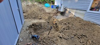

Looks like those machines made short work of the trenching.
But still a lot of hand digging at the ends -- looks like a lot of work!
Z
Zengineer
Apr 10, 2010
781
British Columbia, Canada
Great progress and good planning ahead for the under slab services.
Yeah as much as there is a desire to "send it" at this point, I'm trying to think ahead as much as I can here.
You'd be surprised, this is rock hard clay with shale and rock... NOTHING goes quickly, even with a 9500lbs machine. Basically you scrape your way in, a fraction of an inch at a time. I've actually scraped rocks in half before the clay would release them...
The flip side is once it rains it's an entirely different animal!
And as you say, lots of hand shoveling and cleanup required even with the machines.

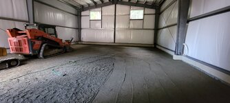

Making some more progress... all subterranean work is complete! (Finally) And now we are at the point of making things less dirty, messy and dusty.
4-6" of 3/4 minus (road base around here) compacted with a 500# plate compactor. A bit more to go yet, but progress none the less. Concrete planned for Oct 25th.
