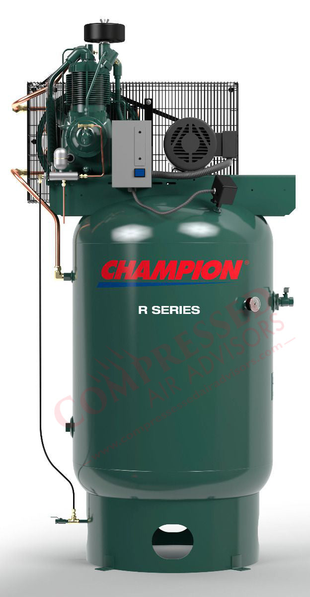

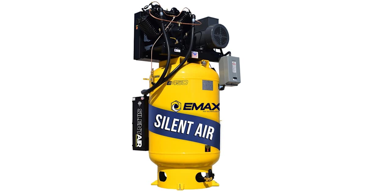

Anyone familiar with an option that's either relatively affordable ($4000, $5000) or somewhat quiet? Upright/standing for space reasons where it will be housed.
I actually dont need a ton of CFM, just high air pressure and large volume for tools that are air hungry but used for short bursts. More volume than an 80gallon would sometimes be beneficial as I've learned in the past.
Edit: 7.5HP would be workable as well
Suggestions?

Did you look at the usual suspects like Quincy, It, Atlas Copco?
You can't run a 5hp motor off a plug (unless using a very expensive pin and sleeve) and since this isn't portable, there's no benefit anyway. Hardwire it with a disconnect

Oh, that's actually a good point. Thank you.
The breaker is good for 100A, so I guess 7.5HP would be on the table then if it needs to be wired anyhow.
I was looking at this due to the quiet aspect, as where the compressor is located is somewhat close to and the next story below the family room:

That looks like a hell of a unit

I have a Quincy QT 7.5 with an 80 gallon tank. It is a good compressor and I'm sure it would do what you need it to do as far as air delivery, but it is LOUD.
That Champion pump in the unit above runs at 949 RPM, so I'm thinking that'd almost be as loud as my Quincy which is something like 1050 RPM.
What are you doing that an 80 gallon tank isn't big enough???? I've done everything including pressure pot sandblasting with mine and it keeps up fine. Yes, I use the small nozzle when blasting, but ....
