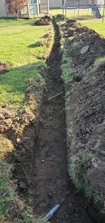

While I'm doing all this digging in the backyard and running all the utilities, I am also going to be adding the infrastructure for a 16-Zone sprinkler system with master valve. Tonight I finished setting up the piping for the Pressure Vacuum Breaker (Zurn 1-720A).
In the background are 12 rolls of 1/2" Oxygen Barrier PEX for the Radiant Floor Heating.
