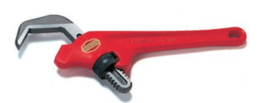

I find the 15" Monkey Wrench incredibly useful for Sloan plumbing fittings and HJE has a very nice USA Diamond Auto Wrench.
I previously carried the Ridgid Hex Wrench, but removed the wrench from my mobile cart after rounding the corners on Sloan covers. I initially fielded a 12" Monkey Wrench, but found the jaw depth too shallow to reliably use on the Sloan covers.

When I did commercial maintenance I used a combination of large Milwaukee smooth jaw pliers, rubber strap wrenches, as well as variety of crescent wrenches.
Have not found anything I could not get off with some common sense (of course no damage to the fictures).
Funny thing is I bought those rubber strap wrenches over 20 years ago for automotive use.
