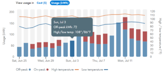

Some follow up info about the electrical. The units went live on Monday July 4 around 3pm with set temps of 85 F. On Sunday July 10 around 3pm, I set them to 70 F. Monday July 11 3pm, I set them back to 85 F.
Electric the day before powering up the mini splits:
The day the mini splits started working:
My experiment Sunday July 10 setting the units to 70 F:
Setting the units back to 85 F:
My previous "normal" was 60-70 kWh per day. With the mini splits cranked, that can at least double. Set to their minimal cooling, it's about 100-120 kWh per day.

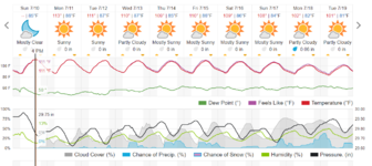

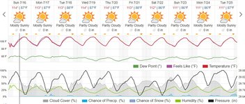

If I could go back in time, I would have invested in better insulation in the building. That will be a long term project at some point.
Against the current temps, these units take a long time to cool the 30 x 50 building if the initial temp is high. Certainly part of that is the mass of the building and it's contents. If I run the units at night to cool, they will maintain in the low 80s.
Yesterday (Saturday), the units were off. I turned them on to work out there for a short while.
There are two dots about 11am to 2pm showing when I started cooling and when I shut them off and the results. The red ambient temp line is the correct shape but shows cooler than actual temp. Realistically, the room cooled about 5F deg/hr and the start temp was over 100F inside at 11am.
