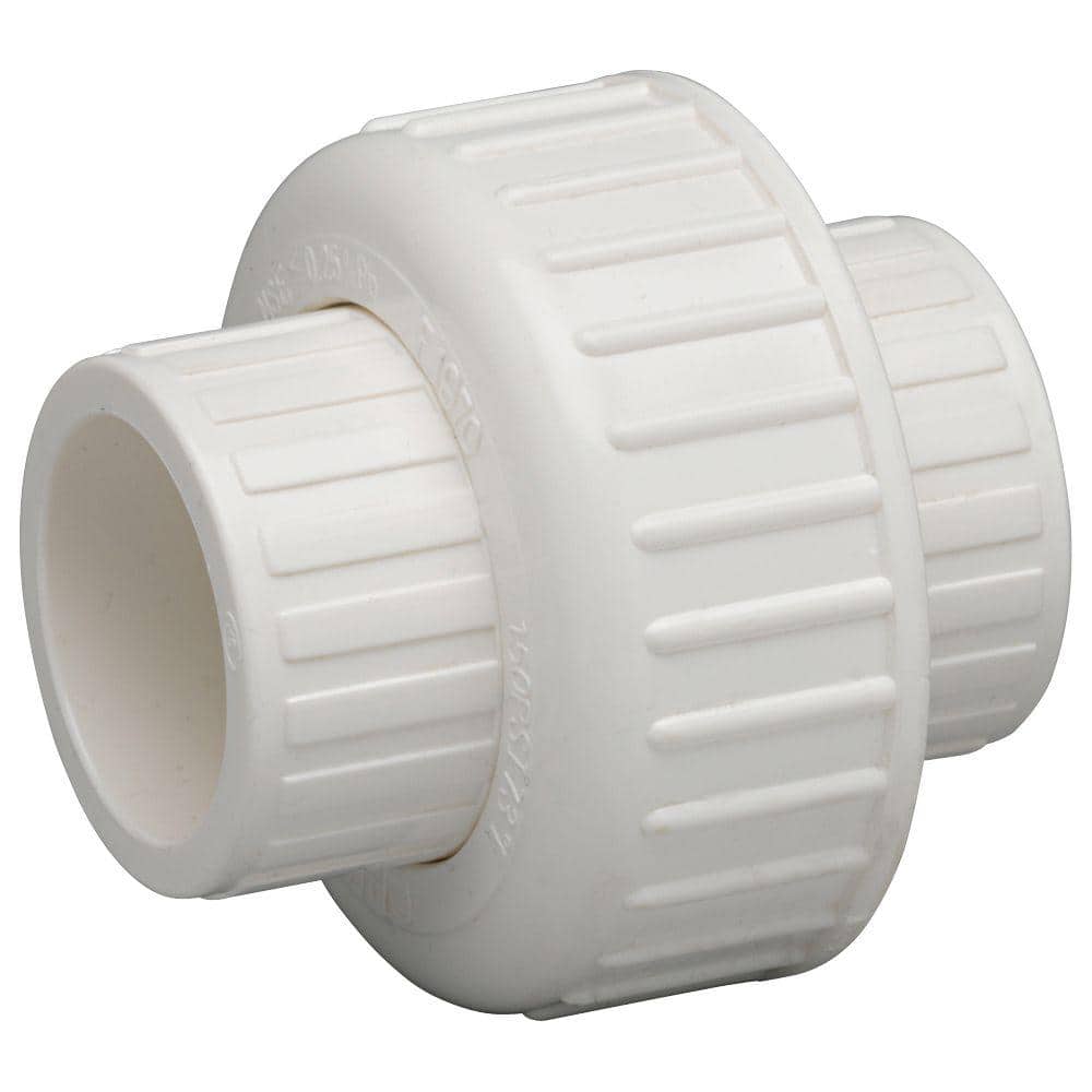

I looked at the pictures again, make sure you block the vent with your hand on the drain when shooting air in there so all the pressure goes all the way to the pan. And Im talking about the section of drain before your condensate pump. I also notice that there are no unions installed in the drain for easy removal to clean. You might want to consider installing some for the future, I would put one right below the tee coming out of the evaporator and in the section of pipe by the dehumidifier. That way you could remove the pipe and screw out the fitting in the pan if needed
