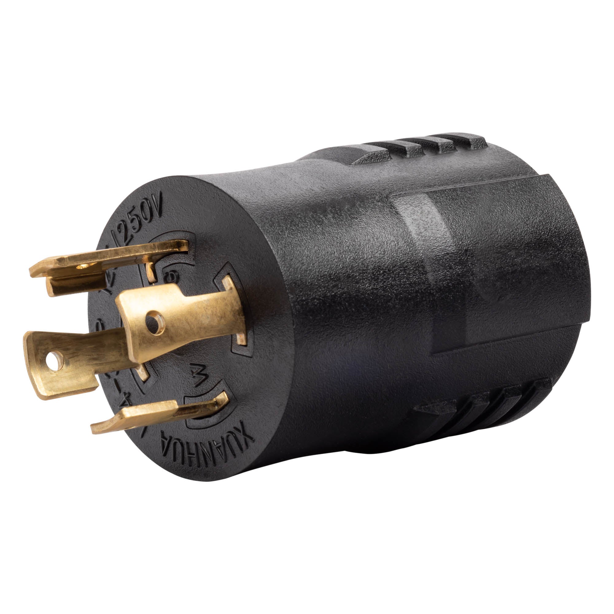

I read it as the opposite problem. The new generator is 120V only, in which case there's no possibility of unbalanced loading.
We don't know how the camp is wired. Hopefully they are all 120V loads, and splicing on the right plug properly is all it takes.

I’m reading it as a typo. I think I he has a camper. Not a camp. And he has a male terminated cord L5-30P he usually plugs into an inverter generator. Now he wants to plug that cord into a generator that has the L14-30R on it. So he needs an L5-30R to L14-30P adapter cord.

Modesto, CA
Power coming out of my camp is the 3 prong and that generator is waiting on an ignition module. I Want to use my other generator in the meantime
But need an adapter
here is what you need but its gonna cause the genny to be unbalanced
