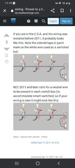

I am an electrical novice so I took a few photos from the attic space above the garage and tried to draw what I see, with the second lamp holder added. I omitted the grounds for simplicity, and pretended blue is white (neutral).
Looking for feedback regarding whether what I've drawn up is logical and won't cause any obvious issues. I understand codes are local so I'm just looking to see if this is the basic idea.
Essentially I'm asking if I can just add 14-2 Romex via pigtail at the existing light to the red switched hot and white neutral. Seems there's an unused slot on the box, so a simple job if I'm thinking about this correctly.

simply add 14-2 to the wires that are feeding the existing lampholder
Thanks! Took me longer than I'd like to admit to understand the current situation since the switch is not receiving power first. I'm a mechanical guy... or at least more mechanical than electrical.

Looks like it does to me. Line goes to switch then to light. Neutral runs straight to light. If the line went to the light first, it would be a switched neutral - which would make the light go on and off but is not good practice for wiring a light switch.
There's no wiring running directly from panel to light switch - it runs to the light, then to the switch and back.
I think it's like the bottom arrangement here, just with one light currently:
I think I see what you're saying though. The switch is still in the hot black wire rather than running through bulb and switching on the neutral side before returning to panel?

The wire goes first into the box that the existing lamp is in, but the circuit takes it through the switch before it gets to the lamp. They are using the lamp box as a junction box for the wiring.
Think I've got it now! And that keeps the outlet hot at all times. I suppose I understood the path, but was not describing correctly. The junction box explanation makes sense.

If power is fed to the switch box first, there has to be a neutral
I'm probably not asking the right question again. Guess I'm asking why they did the below version of this:
With only one light on the circuit, couldn't you simply do the top version and run switched hot white wire directly to lamp holder? Thereby running 2 wire Romex instead of 3? Most areas of the house seem to have the cheapest possible installation.

It was uncommon in the 90’s to run the neutral to the switch because it cost money and performed no function as evidenced by its being coiled and nutted. Good to have these days though so you lucked out.

It was fairly common in bedrooms especially. Power to the light box, 14/3 to the switch (hot, neutral, ground, and switch leg). Then 14/2 was pulled to the receptacles from the switch box, and also from the light box, maybe to the opposite wall, maybe to another bedroom. I've never done it that way, but have been in plenty of houses that did, going back into the 1950's. I'm guessing it was to save wire, which it probably did.
OP: don't worry about it. All you have to do is run a cable to the new location and hook up to the same wires powering the existing fixture.
