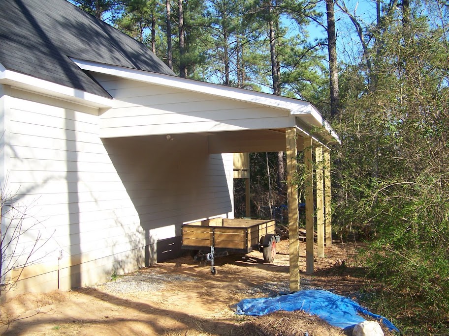

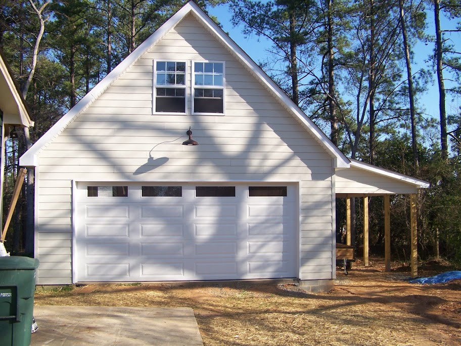

Here ya go, E-tek...my lean-to:
1st, some construction photos:
Back half that turned into a small drive-thru shop:
Rear view of the little lean-to shop:
Front 'carport' half:
With face added:
If you notice, as I was under construction, the rear half actually was a lean-to to my garage while the front half lean-to became the basis for enclosing the stairs to the 2nd floor.
Here are finished photos:
Front:
Rear:
When all was said & done, I had added aother small lean-to to the rear to house all my lawn equipment; and both lean-to's (shop & carport) open into another small lean-to shed that is accessed only through the shop/carport lean-to's & is hidden by the Spuce trees.
Looking through the carport lean-to:
Looking through the small shop lean-to & its opening into the garage:
& a sketch of the building footprint:
It actually turned into a pretty large lean-to addition:
Small Shop (center room): 22x16...yep, clear span lean-to using trusses
Midget Room: 14x16
Carport: 15x16 (stairs to 2nd floor take up the other 7')
German Room: 14x16
Lawnmower Lean-to: 12x12
&, finally, a photo from the side away from the garage:
I think it is visually appealing.
