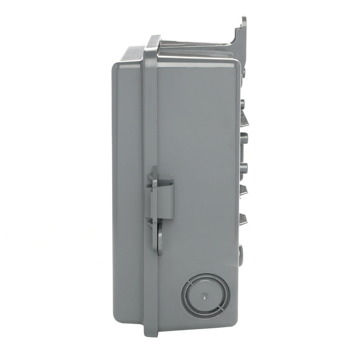

I have a indoor swim spa that was installed by previous homeowner. The main panel is a 200a GE Powermark Gold Load center and it has a 60a 3 pole (non GFCI) breaker with 6/3 wire going out to the spa Cutler Hammer disconnect box. I was told by a spa service tech that the 60a breaker needs to be GFCI.
There basically are no available GE gfci breakers ( GE-THQL2160GF1) out there. Wondering the easiest (but safe) way of accomplishing this.
I came across a Siemens breaker on amazon and a reviewers post (see pic) who describes putting this breaker into his GE Powermark panel and "creatively" isolating the nuetrals at the disconnect but does not show this.
I am attaching pics my current disconnect box. Not sure whether I need to hook up a subpanel next to my main or in place of my disconnect (tight space). Thanks for any input!

What is that disconnect box attached to?
Where is it located relative to the spa?
As Mike said, changing the disconnect is likely the easiest solution.

Hey PC, It is attached to a 2x4. I don't see the box being grounded as the ground wire goes straight thru to one another. The box is right next to spa through an access panel. I forgot to ask Mike about the separation of neutral and ground in this new load center he posted. Do I need to get a neutral bar and isolate being that it is serving as a subpanel? Thanks
Beyond the first means of disconnect, the neutral and ground must be kept separate.
The Schneider website says it comes with a ground bar. See the product datasheet

If you end up keeping the disconnect you currently have, the enclosure should be grounded. There should be a threaded hole on the back wall. Thread a ground screw into it, attach a ground wire to it (the same gauge as the ground wires in the cables), and connect it to the other 2 ground wires and wirenut them all together.
Also, get a knockout seal to plug up that hole in the upper right corner.
If you end up replacing the disconnect, you still attach the grounds the exact same way (unless it already has a ground bar, which would already be bonded to the enclosure. In that case, just connect the 2 ground wires to the ground bar). Since it has a GFCI breaker, there will be specific locations to connect the incoming and outgoing neutral wires.
