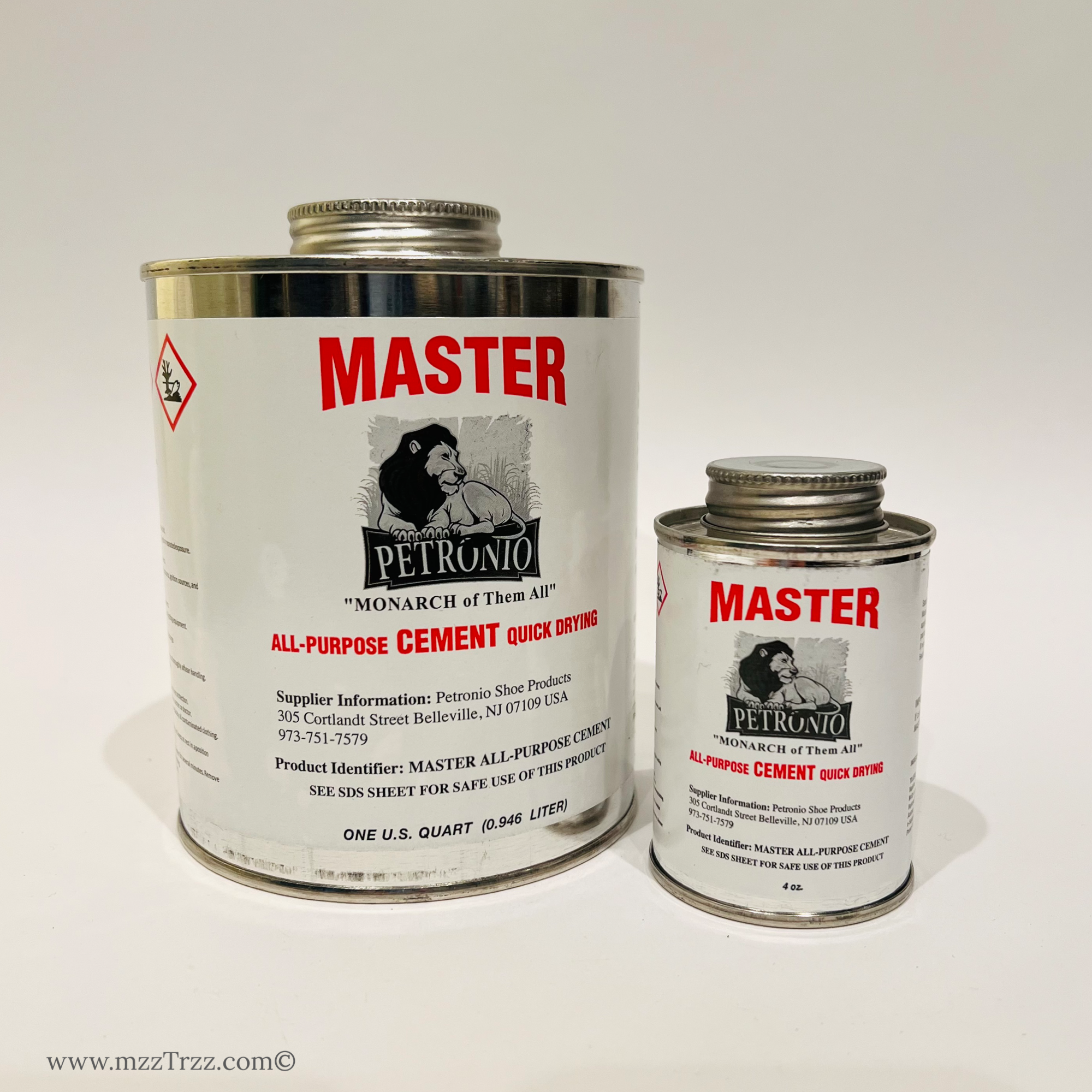

There's this cobbler on YouTube who does shoe and all manner of leather goods repair. He uses Master All-Purpose adhesive. I know most of his usage is leather to leather, but he does suede, rubber, Vibram, nylon fabric, and plastic with it too. FWIW

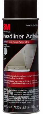

I use this and it works great, even in the heat of the South:
