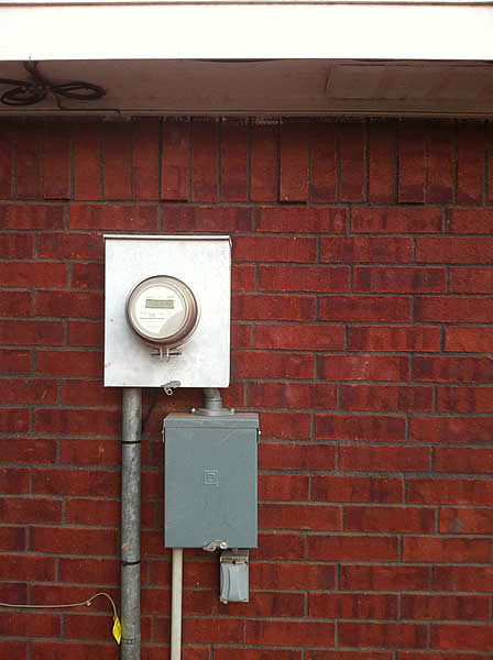

I'll have to post a pic of the other end so people are clear on that. The shop end is a drop out of the eve, total 30' of conduit. The other end is a Square D Homeline 6 slot 100A box tied into the meter can. It's about 4' down from the eve on the side of the house. The utility used the top of the box for the in feed, so the only real option is out the right side. If I El and go straight up, no problem. If I sweep out - right into a vent. Further thought might classify that at a "good thing" - I can drop my cable out of the vent hole in the eve, then make a cover from some of my left over HardiSoffit and just run the up conduit through that. I could put a box under the eve and go from #2 AL to #3 or #4 CU - but why if I can just run it into the box.

After a shopping tip to Lowes, I cheesed out - bought a 6x6x4 box, some fittings, some good size aluminum splices, anti-oxidant and cable lube. I wasn't finding any C bodies in 2", but this is the same just different. The box has a nice weather seal on the cover. I'll mount the box at the eve and splice the wire in there. I'll make the whole thing an easier production. I can bring the attic leg from the garage opening and only have to handle the last 20' or so to the eve over the dining room. I can pull the ground part though the conduit then stand the riser and box up under the eve. Easy.
I also eyeballed some LBs at 1 1/2" and that should work for the other end. If I go out the side and straight up, I'll just miss the vent. Pic of far end where the breaker will reside:

I do not recommend pulling wire into any conduit that is not completely installed. You are only asking for problems by pulling wire and then thinking you are going to stand up the conduit and it be easy. What is easy is to damage the wire this way. Complete the installation of all conduit boxes etc and then pull your cable. Conduit runs and placement of boxes need to be planned out to ensure you can pull the wire safely and effectively.

Good advice - there's only 7' of difference in the run anyway and that is straight up. I seem to keep blowing off exactly how stiff this wire is. I have to go out and grab it, then get the "oh, yea". I would have had the conduit and box in tonight but it turns out I have every size hole saw except the 2 1/2" I need for the box fittings.

Chris it looks good. Add a few 1 hole straps to your conduit and you will be done.
LOL - Left off the bushing from the conduit in the box. I'm looking for some proper sized clamps to steady the conduit. I planned to use a couple of conduit hangers on the wall behind the pipe but both stores have been out of 2" sizes. The pipe is about 1" off the wall.

With PVC the bushing isn't a show stopper. Now if it were rigid conduit then that is a different story. Fab up some 1 x 2 strips to mount to the wall and attach the straps to it to make up the difference since the conduit is not offset back to the wall.
