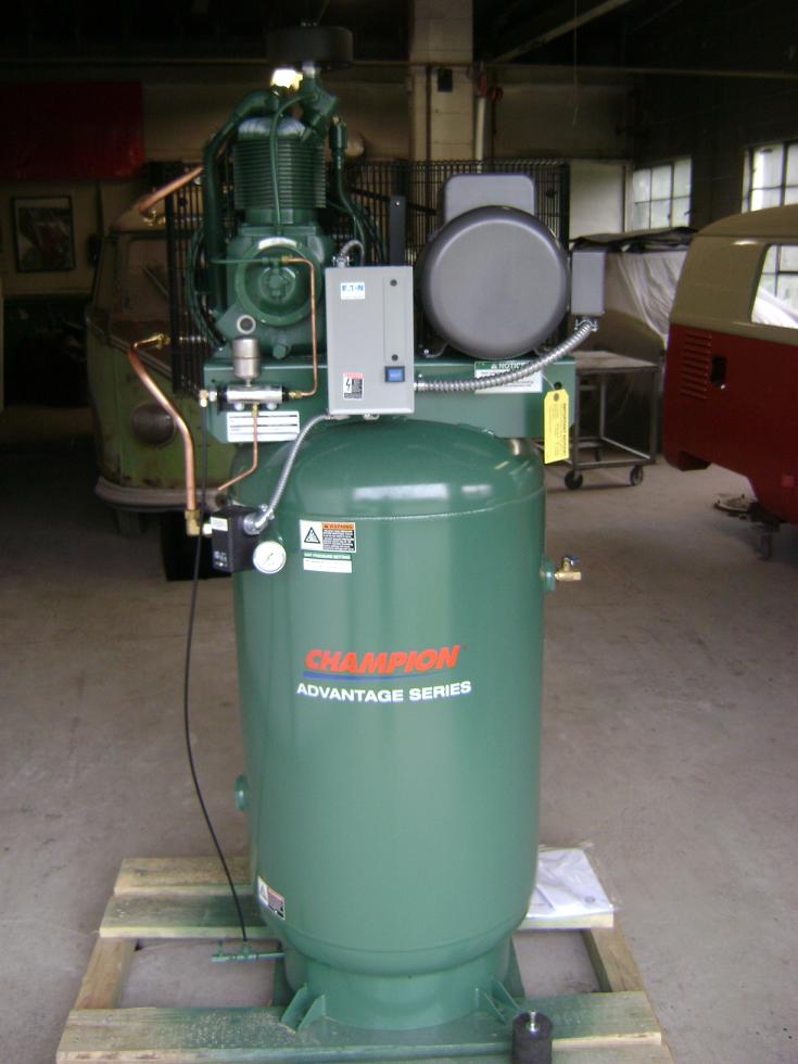

hi, wondering if somebody could give me a pointer on hooking up my new compressor. the mag starter on this one looks different from my old one, and i just want to be sure i hook it up properly. the starter is already run to the switch, so i just need to hook up the black and white wire from my breaker box. does the black wire go to the upper left (L1), and the white go to the upper middle (L2)? the starter is a single phase.
thanks in advance and here are two photos to show the set up.

It looks like a 3 phase starter wired to run a single phase load to me but I'm no expert. I'm just giving you a bump...
I take it your feeding it 240V single phase?
What size cable and breaker?
What are the requirements of the compressor?
I'd say L1 and L2 is right, but don't trust me. With 240V it makes no difference which wire you connect to L1/L2.
I'm curious about the small red and black wires, where they go, and what they're connected to internally and externally. No doubt one set is to the pressure switch.

thanks. yea, its 240 single phase. i'm using 10 gauge and a double 30 amp breaker for my other compressor at the moment. this one calls for 35/36 amps i believe. the extra smaller wires go to the low oil shut off switch.

can anyone tell me why power would be going into the magnetic starter, but not coming out where it feeds the motor? i have power at my pressure switch as well. this thing has a low oil shut down switch too, can these be faulty?
71flh
Jun 15, 2011
379
What do you mean by not coming out?
How did you connect power?
Does the starter engage?
Do you measure 240V across L1-L2?
What do you measure across 96-98?

by not coming out, i guess i mean that power is going into L1 and L2, but not coming out down at t1 and t3 to feed the motor. im going to try and find an electrician tomorrow who knows about compressors. i'm getting frustrated and don't know much about electrical other than very basic house wiring.
L1 reads 123 and L2 reads 123 volts.

You want to put one meter lead on L1 and the other on L2 to make sure you're getting 240V.
What about the measurement at the motor side? T1-T2 and/or 96-98

i tried to get a reading across the two, but it still only read 123. t1 and t2 show nothing at all. 96 shows 123 because its run through the low oil switch which gets power from L2.

You have a wire going into L1 & L2, then you mention T1 & T3? Have you tried T1 & T2?

Seems to me L1 & L2 should/must go to T1 & T2 not sure of the jumper going to T3?. I've manually closed a three phase mag switch with a piece of wood while trouble shooting.
71flh
Jun 15, 2011
379
I'm also wondering why the jumper is there, but I doubt that its a problem. It just seems to route current through the 3rd set of contacts and heater.
Thus T2 and T3 are pretty much the same point electrically if the contacts are closed.
Maybe he's only got one leg of his 240V power feed.
Flip the breaker off and back on?
The drawing in the first pdf from the post by dwm is informative.
It looks like the red wires are from the low oil SW.
The small black wires are from the pressure SW. Its hard to tell where all the black wires are connected. The coil connections can be seen behind L1 and L2 in the background of the 2nd pic.

thanks for all the advice, guys. my compressor guy/electrician showed up today and it turns out that i have a bad meter base for my shop. i was getting 120 from each leg, but not 240 when you check between both. the electric company came out and pulled the meter and the one lug for the wire incoming was rusted/burnt nearly off! the strange thing is that my last compressor was a 220v, but the motor was only a 5hp. not sure how it limped along like that. i ran it up until yesterday. ***** to spend more money, but probably good that i caught it now before burning up this unit.
anyway, enough rambling. thanks again for the help, i really appreciate it.
