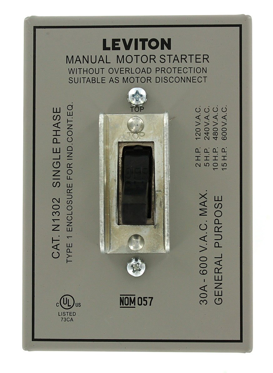

I am going to put my 220v air compressor in the back of my garage (outside). I'd like to turn it on (and off when not in use) inside of my garage. I don't want walk from my garage to the back to turn my air compressor on (or off). I am thinking about install a wall switch (with label saying "AIR COMPRESSOR").
Any suggestions, ideas or advice for me? thanks
If you have that kind of switch for your air compressor, please post a picture of it...thanks again.

leviton N1302-DS
They have in wall version too.

I am putting my 230v 5hp 2 stage compressor in a shed, 20 feet from shop,, I plan to put the "wall version" in a switch box, but want to add an indicator light,, Ideas?

You can run the light out of the switch output into another box with it, or you can tap off the components of the compressor. but IMO you would not need it, you can see the switch is flipped up at down if you put some bright paint on the lever.
