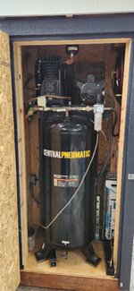

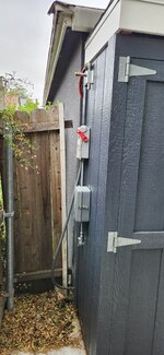

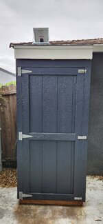

Honestly a shed/enclosure off the back of the shop might be the best solution. Get it out of the shop completely. My shop is smaller than yours and it was taking up a ton of space, plus it was noisy and gave off a lot of heat.
I originally built a larger shed to house both the compressor and lawn tools in the same style as our other general storage shed, but we ended up relocating those so I built another dedicated compressor shed with enough room for a small hose reel and some other odds and ends.
It has a pool timer and a shutoff switch accessible from outside the shed. It also has a solar powered exhaust fan on the top to help pull the hot air out as well as a soffit vent.
