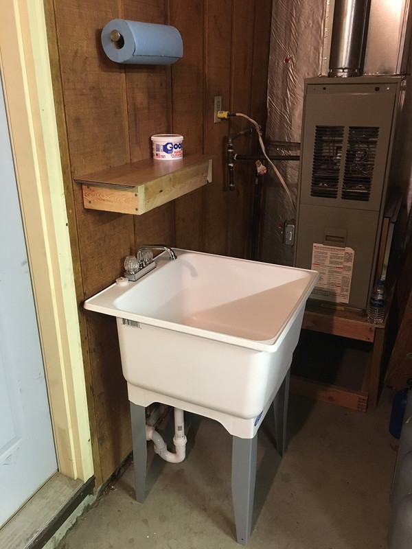

How do ppl like a traditional furnace for garage heat. I'm leaning towards a 80kbtu 2 stage furnace thinking that the low stage will be ok for maintaining even 50F and 2nd stage for pick up. Just nervous the 60k btu Reznor might be undersized for 1470 sqft.
I have one in my attached garage. its about 30x26. I made a stand to get it up off the floor for code. It heats up fast. zero complaints. My detached building i'm looking at the 50k btu mr heater big maxx ceiling hangar for the 32x28.
