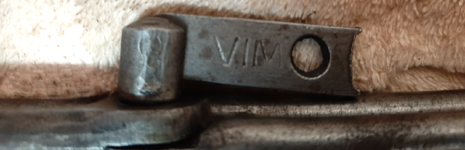

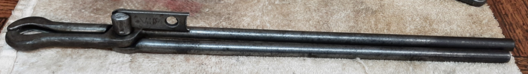

This came out of a box of tools that I got at an estate auction. The only marking is "VIM" on the rectangular piece. Alloy Artifacts says the Vim Tool Co. has been around since 1931 and made specialty automotive tools. I'm curious about what this tool is used for. Any ideas? Thanks in advance.

Perhaps a valve spring compressor for flathead engines. The "pliers" clamp the bottom of the spring/washer and the fold-out bracket is the pivot point pushing against the bottom of the valve chamber.

"Valve lifter" according to posts in the VIM thread.

Thank you!
