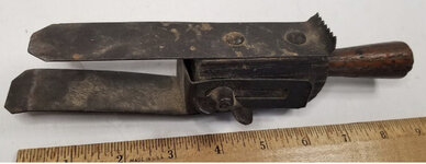

Any ideas on this vintage tool? It came from a Toledo Ohio estate sale, one of several just like it. Posted here from another forum that is running out of ideas. Any help with the ID appreciated.

It's a siding or clapboard gauge, maybe craftsman made rather than a factory item, but nicely done. Used to hold a piece of wood lap siding in place while installing it. One of mine is a Stanley No 89. Attached is a page from an Audel's manual showing the use.

Here's the Stanley No. 88 that was in my "what's it?" category for years, before I finally looked up the patent date and figured out what it was.

Well done! Thanks to both replies and excellent explanations. I can't believe I didn't see it, but I was convinced it was something else. I've made something similar to help install Hardi Board Siding. The HD version is pictured.

I have my grandfather's (maybe my great-grandfather's) Stanley 88 and 89 and also a couple of others by other companies. Handy tools if you ever need them. It would make sense to have a pair or more of them.
