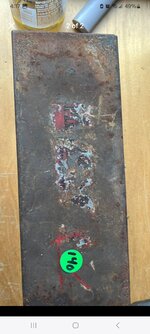

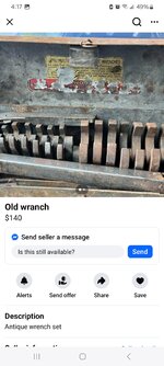

Any ideas on this one?

The manufacturer is Park Metalware, which would become Xcelite, changing their name to the brand name of their most popular later product, after 1953. They made several size sets of the interchangeable wrench heads. That set, their largest, had two different size handles for two ranges of heads, smaller and larger. We have a Park Metalware thread. A few of these sets, including mine, are shown there. You can find it in the A-Z Index of Threads in the Sticky.
