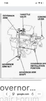

I was pressure washing a deck for a customer tonight getting ready to stain it when my Honda engine quit. I got it to start back up but only at an idle. I found if I pushed on this linkage it would rev back up, the further I pushed the higher the rpm I haven’t done any YouTube searching yet but I will. Was wondering if anyone here knew anything about these? I believe it’s the governor but I could be wrong about that. Actually now that I think about it, when I lift the throttle handle to increase rpm nothing happens so maybe just a broken spring? I will have a look at it tomorrow

I was able to find 3 or 4 good videos showing how to set the governor on this particular engine, seems to be very easy to do. I will find out tomorrow if that is the problem

Thanks for the reply but if I push on the bar lol it idles up fine. I’m going out to look at it shorty here. Got caught up yesterday fixing a friends Honda 690 engine on his wood splitter.

Does it have the lever with a clamp on a shaft such that the shaft torque pushes the lever ? Has the clamp become/been loosened such that the lever is slipping/allowing rotation of the shaft to not take the lever along with it (as it is supposed to work)
be careful if trying to work on it ,a mistake could cause the engine to run away with itself causing it to grenade in seconds

So the problem easily presented itself, spring halfway up the governor arm is broken on the the throttle lever side. I started it, and pulled the spring as if to attach it to the throttle control lever and the rpm’s increased. I will say, not any spring would do since it was very responsive to the torque put on the spring, had to be just the right tension. I will see if the Honda dealer can tell me what part number it is since I can’t find it for sure

I am thinking that it is probably just the garden variety governor spring that pulls to open the throttle against the opposing force from the governor mechanism and that the unloader system is probably not involved (with the problem)
If there is a manual speed adjustment for the engine (like turtle > rabbit) that will be set up so that the spring is stretched longer on "rabbit"

Yes, when I push the throttle lever up making the rpm’s increase, there would be more tension on the spring that attaches at the throttle lever and goes to mid point on the governor arm.
My research says I need spring 16562-ZL8-000 and the Honda dealer says I need spring 16561-Z0J-000 the one I think it is is 6.39 and the one they say it is is 1.10 so I ordered both. AI says they are very similar and they I would use the one I found. My model is GCAHA6044864

IMG_8644.jpegIMG_8631.jpegBoth new springs came in today, the one I thought it was and the one the dealer said it was. Both springs are the same length, the spring I thought it was has more coils but still the same length.
Anyways when I put the new spring on, it runs as it should but when I throttle it down, the spring falls off? The new spring looks to be the same length as the old broken spring.
The hook on the throttle lever side was broken off of the old spring so I can’t see how it was installed,
