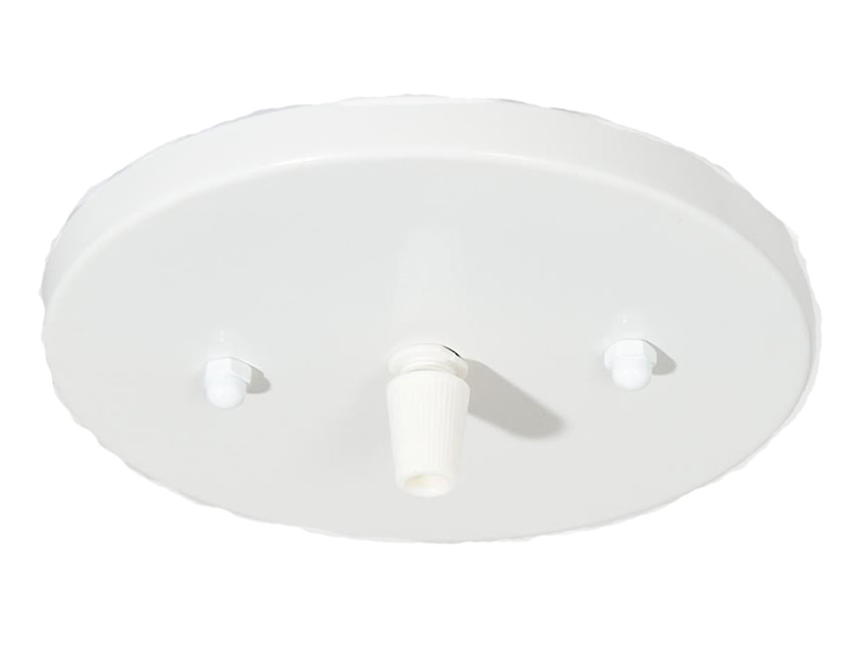

Here is a metal canopy kit. You would have to use a unibit or knock out to enlarge the center hole to 7/8". That is the size for 1/2"fittings. It even has the ground pigtail to bond it. You would just cut the terminal off one end and wire nut it to your equipment ground. It does come with a small strain relief for cord, you might just be able to use that.
W
WP9
Nov 26, 2014
81
Thanks Terry!
