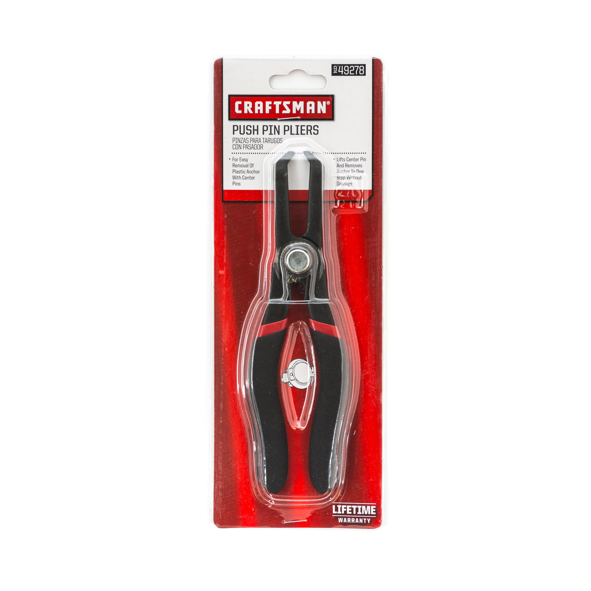

Are push pin pliers to remove clips worth buying? Or should I just stick with using a screwdriver?

They work great - just got a pair few months back. Much faster than the screwdriver!!

We are talking about two different things here. The push pin pliers are about as good as it gets for pulling the center pin out, then the HF or Snap-on pry tools shown above are great for pulling the whole clip out. The HF and Snap-on pry tools are useful on many different clip styles whereas the pin pliers are really only useful if you have vehicles that use that specific style trim clip. Other vehicles use different style clips or have pin clips where the pin is just a rod with no enlarged head and you just push it in instead to shrink down the tabs of the clip. I like my straight pin pliers, but I also have a pair of I think 60 degree angled pin pliers and I use those more often.

I bought it, but seldom use it.
Instead, I use the plastic trim removals.
I think plastic on plastic is less destructive.

I have the set that comes with straight on, 45degree offset pin pliers as well as the panel popper tool (only allows one inch of movement from closed to open - awesome for really tight door panels that have never been popped off before)
I don't use them all the time, but when I do, those pins come out like butter.
I watched my friend use a really cheap pair of mini needlenose pliers that had the ends bent to get underneath the pin. He had the right idea, I just hate junky tools. The tips were like butter too.

I would use them more if they could be pistol gripped. Using a tool that interferes with being able to see what you are doing is somewhat defeating.

I use them and I think they work way better than a screwdriver. That being said, those Steck pliers posted above look nice.

I just push the pin in to unlock and pull with my regular panel tool. I have those pliers. I have never once used them. So to me no they are not worth it.

I have a couple Saturn vehicles that use a million of these fasteners, I use a pair of HF push pin pliers to pull out the center pin (I sharpened the points on my bench grinder so it gets under the head of the center pin easier), then use a Tekton panel popper to take the body out. The panel popper is also great for door panels that use the "Christmas tree" clips. For the Phillips head pins, there's really no good way to reuse them. They strip out or spin the first time you use them.

Yes they do work and are worth having but if your roads get brine/salted/sanded its worth buying some of the Chinese knock-off clip sets as there are many instances you'll break them no matter what. One of the few areas i'd advocate cheap aftermarket, OE prices on the things is stupid and im not a huge fan of doing what most do which is zip tie everything.
