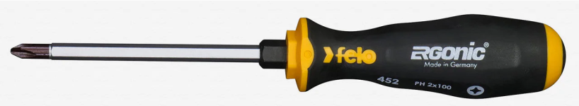

screwdrivers
Hex bolsters may be of interest
The Felo grip is great, quite unlike all others
Or a ratcheting T handle (doesn't need to be fancy, but you have a good excuse)
Hydraulic impact drivers
There's a whole range of screwdriving options underneath too if you have more delicate needs - 3.6V stuff, 7.v stuff, 12v non-impact screwdrivers, Japanese style pen drivers.

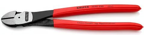

Are the 8” high leverage diagonal pliers large enough to cut old buried cable and coax line without too much joint stress? Or do I really need the 10” diagonals, or do you recommend something else?
YesIHaveAHammer
Jun 1, 2025
1,013
My Wiha screwdrivers are an absolute joy to put in the hand.
I'd noticed they are of larger diameter than others, perhaps this helps.
If this is any domestic electrical cable, 8" will do it easy, and coax TV line will be a doddle.
I considered the 10" a while back and concluded they'd be so cumbersome I wouldn't use them much. This post I found made the point well:
8” gives the best combo of size vs leverage, IMHO, and belive me, ive tried experimenting. Its basically the sweet spot of having handles long enough that will maximize how much your hand will comfortably open and close. If you go bigger, say 10”, youll find you’ll wind up holding the handles in the same spot as an 8” pair. If you go smaller, youll find yourself holding the handles at the very edge, and having to use more strength to cut hard stuff cause you lost some leverage with the shorter handles.
Note that Knipex have a new version of their 10" high leverage with a revised joint design, requiring 20% less hand force. The part numbers are the same, so it might be tricky with online retailers to know which version you're getting.
The high leverage diagonal cutter (at 0:40) 74 series in size 200mm and 250mm (not on the website yet), has been updated with 20% more leverage. I expect the design will trickle down to smaller sizes. https://www.knipex.com/knipex-diagonal-cutter
Below is the old version. Notice the relative proportions of the head vs. handle length. However, leverage is a trade off, so I expect the new ones require more handle movement for the same amount of jaw opening.
