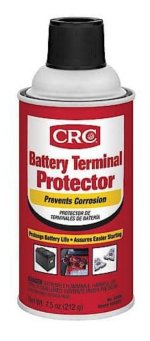

I always use the proper product for the application after I clean the terminals with baking soda or battery terminal cleaner. Get the terminals clean and shiny, tighten them up and then apply a proper terminal protector. ALWAYS WEAR EYE PROTECTION when cleaning up battery terminals.
BTW! NO Grease of any kind or sticky products because they attract dust and dirt.

I use the battery terminal protector spray that several people listed. this prevents battery acid from corroding the battery cable clamps
I also spray it on top of the battery to prevent any seeping acid from travelling on the battery case towards the terminals.
