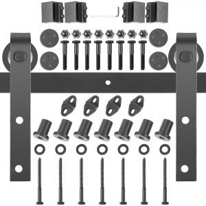

I am working out some of the details on my small barn design (16' x 24' or 18' x 24') and need to settle on a door type.
The door is currently slated to be 9' wide x 8' high and I prefer the look of a split sliding barn door setup but I'm not sure how watertight or secure that would be. It is also difficult to find legit barn door hardware online since every search I can done returns the interior barn doors that are in style now for folks who are doing that look in their house.
There will be no electricity in this barn and no man door so whatever large door I go with is the only one.
Where can I find sliding barn door hardware? Where can I find manual roll-up doors that I can lock and operate from the outside?
Pros and Cons of these two door are also welcomed!
Thanks.

I went with a sectional garage door on my barn; same type used on homes. Seals well and easily lifts by hand.
I was originally wanting a true carriage door, but the sealing, out-swing crash with snow, etc, convinced me to go sectional.
You can get faux brackets to make it look like a carriage door. Example found on the net.

Big box stores should have barn door hardware, search their websites for exterior barn door or exterior sliding door. If you have a Fleet Farm or Tractor Supply in your area they may have it too. A sliding barn door will be harder to seal up against weather and little critters.
When you say roll up door, I assume you really mean a sectional door like shown in post #5 - they're available literally everywhere, big box stores or any community of any size will have one or more garage door supply house. For just one example, search for the Overhead Door Company website, and click on the red Find Distributor button in the upper right corner.

Many roll formers ("barn metal")
will have accessories such as the rolling door hardware.
Tractor supply around here only has enough in store inventory to tease you. You'll want to have knowledge of all the various accessories - track, rollers, door guides, latches and even aluminum extruded frames for fast and stable door framing if you choose.
This is just one page of dozens of rolling door options, round and square track from abmartin.net.
They have a comprehensive catalog that you can bring yourself up to speed with anything imaginable to do with ag buildings.
They are in PA and much of their stuff is pick up or locally delivered just like any "lumber yard".
If you know what you need (by researching ab martins online catalog) ordering locally will help immensely with the counter guy at the local place that doesn't know anything about these products.

I have a 12 x 12 opening for my barn doors. I got the hardware at Tractor Supply. I cast a slot in the concrete to retain the bottom of the doors. That also keeps rain water out of the bottom. I use De-Sta-Co toggle clamps to pull the doors tight to the frame when I close it up. It's tight enough that mice don't get in. I made my doors out of 3/4" plywood covered with 1x6 tongue and groove planking, and 5/4" trim boards (actually pressure treated deck boards. They've stayed flat over the years. Yes, they are very heavy! I had to make a small 'roof' out of flashing over the track to keep rain water from pouring down the inside of the door. They sell a brush material that could be added for better sealing on the sides and the top, but I haven't bothered yet.

I went with sliding barn style doors on my new build 5 years ago. But my barn is insulated and heated and I was just not happy with my attempts to seal those doors adequately. Lasted one year....and then I removed them and replaced it with a solid wall.
It's your barn, but I would recommend you rethink your plan to NOT include a man door. barn door.JPGbarndoor2.JPG

I had sliding doors with exterior tracks on a pole shed, and without going to the extent that @MushCreek did, I was lucky to keep a cat from sneaking past the door, let alone a mouse. Much easier to use a regular overhead garage door.

The problem I see w/ sliding doors is sealing and security. Generally they are a pretty sloppy fit although you could certainly improve that. It also seems to me that in many cases the latches etc are on the outside which makes them pretty easy to attack w/ a crowbar. If you add a man door, you could put latches and things like cane bolts on the inside so easily make the door more secure.

National hardware sells the traditional stuff you are looking for. It is hard to find on the internet. But it’s all there. You will find places that carry it like country hardware stores.
I’ve purchased a bit.
The barn doors don’t seal. I put a regular garage door behind for air seal. The barn door is for security and fire protection.

We have both options on farm buildings. Slider setups work but they are more challenging to seal and use frequently. They are cheaper since we build them ourselves.
If you don't do a man door, I wouldn't go with sliders. You'll end of leaving the door partially open because it's too much hassle. In fact, I don't know how I'd do sliders without a man door. Most of our sliders have internal hook/latch systems to hold them tight. Sliders still rattle in high wind with bottom rails. They will rattle themselves open and wear out the hardware faster without hook/latches.
I'm not against sliders. Cost is a big factor. If you go that route, I have some advice. Absolutely include a man door. You can even install the thing in one of your sliders if you're opposed to framing in a wall. Make slider doors with framing that will stay true and not flex or sag. Use good hardware (Rollers, trolleys, and rails) for the sliders and include a bottom guide system that won't ****** up with debris.
@TimberMan , I don't know what type of barn door hardware you are finding? These guys have already linked some good hardware. Around here, the real stuff is on hand in farm stores and local lumberyards. I see stuff in big box retailers that tends to be lightweight and gimmicky looking. We use heavy galvanized hardware with sealed bearing rollers. We also do covered tracks for winter weather and component longevity.
