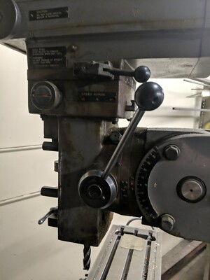

Do have enough space for a Bridgeport? If so consider a used Bridgeport.
Where are you located? Here’s a full size mill in Kentucky for $1800
Here’s a full size mill in California for $2000
Nevada Bridgeport for $2000
If you can find a good deal on a used table top mill great. You’ll find one eventually if you look and wait long enough.
I’m not trying to steer you in the direction of a large mill per se. I was looking for a table top mill and found they are expensive because they are popular. My experience was that I could find a used full size mill cheaper than a used table top mill. The icing on the cake was the additional capability the full size mill gives me.
I use my mill for some fab work. Get some roughing end mills and go slow, you can hog out 3/4” plate.
