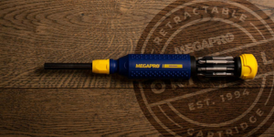

Give Megapro a look.
Good Luck
ETA Link

Megapro - Holds bits in the handle. They have ratcheting drivers that are quite good. Made in USA or Canada (ratcheting versions). The Automotive Ratcheting is my favorite. The handle is comfortable, though it is a bit large. It's magnetic and takes standard insert bits, while the rest take double-ended ball detent bits.

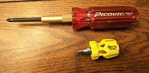

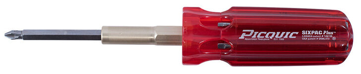

Sounds like a Picquic Sixpac Plus or Multique would fit the bill to me. They both have Robertson bits and the other usual selection of Phillips and flat.
The Sixpac is the "standard" Picquic and uses regular 1/4" hex bits - easy to find substitutes if you want a particular driver.
The Multique uses skinnier, non-standard bits, but the benefit is better access to recessed screws and a slimmer handle (which your wife might prefer if she has small hands).
Picquic's bits are very good quality, precise and better finished than most. Some, maybe all now, have a coating of some kind - maybe a thin layer of chrome? I'm not sure.
I'm not claiming they're up to PB Swiss standards, but I think they're a bargain. Plus if your wife ruins them, it's going to be <$20 for a new one.
P.s. Since you're in Canada, you may be familiar with the Mastercraft look-alike. That is NOT an equivalent product, despite the visual similarities.

Picquic -look no further. I have one in just about every box or drawer.
