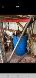

I just picked up this cool vintage Peterson "Cleaning Machine" for $250. It needs gloves and glass but everything else works.
However, the previous owner did some tinkering on it and im trying to figure out what I need to do to make it right.
On the back of the machine is what appears to be a dust collector. However, it connects to the bottom of the hopper, which is obviously full of media. So is this actually a dust collector or just a media recirculator? He also has vents on both sides of the cabinet blocked off. Im assuming to keep dust down, but it doesnt make a lot of sense to me.
He also had a 55 gallon drum connected to the exhaust of the "dust collector", and a shop vac connected to that drum. Which means he had the dust collector blowing into the barrel and a shop vac sucking on the barrel also. Why?
Im assuming the large opening on the dust collector exhaust is for a bag?
Sorry for all the questions but this machine is impossible to find information on.
So to summarize:
1. Is the dust collector supposed to be attached at the bottom of the hopper where all the media falls?
2. Is it even a dust collector?
3. Why would he tape up the vents?
4. Is there a better way to set up dust collection?
5. Is it meant for a bag to go on dust collector exhaust port?
6. Is there a better way to do dust collection?

About 1/2 gallon abrasive goes into the bottom of the dust collector cone. None. in the cabinet. Vents should be open for makeup air intake. You need a dust collector bag on the outlet of the dust collector with a 5 gallon bucket attached to the open bottom of the bag with an elastic band sewn into the bag like a waist band. Nuisance dust collects in the bucket, useable grit goes back to the cabinet through the gun, then returns to be processed by the cyclone dust collector. You got a good style of cabinet there, and you would do yourself a favor to read my abrasive blasting thread. This thread is being added to it.

The shop vac part of it sort of looks like he wasn't using the built on dust collector at all and was using that instead. He blocked off the vents to help give the shop vac setup more suction and was using the cabinet like the kind that ***** the dropped sand from the bottom.

Yeah, that was my thinking too. If the bag system works, I will go with that. The collector works good on this unit so I dont know what he was doing.
He also added air lines and pneumatic cylinders to both sides of the door to lift with the push of the pedal, but its all dry rotted, so I removed them.

So it would appear the side vents are not factory. Somebody drilled the holes themselves.
The actual vent is across the top with built in baffles to keep the dust in. I guess I will have to weld in patches on the vents they drilled.

The vent on a cabinet needs to allow the amount of air to enter the cabinet to not quite equal what the dust extractor can remove. If gloves **** straight out inside there is not enough vent. A bit of internal inflation of the gloves is ok. A cabinet with a good suction will lose little grit because the cabinet is under negative pressure
