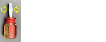

I prefer cabinet tip screwdrivers. I deal with a lot of recessed screws, and I have no use for big, bulky tips. I mean, what's the point of all that meat on the sides of a tip that doesn't engage the fastener:
