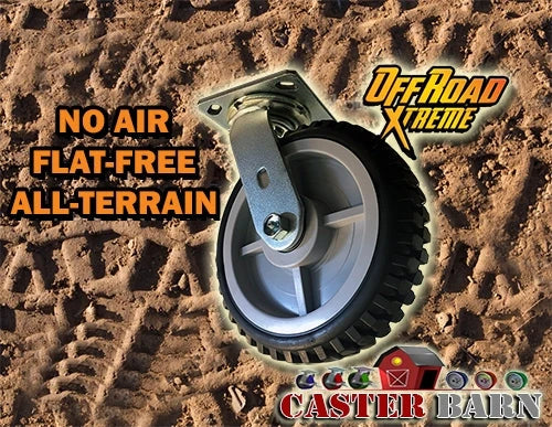

What about these? There are not pneumatic but are 5” dia.

No, traction wouldn't seem to be your problem. You just need more diameter for rougher surfaces. Just as your truck doesn't notice the piece of gravel that would stop a skateboarder dead in their tracks...
