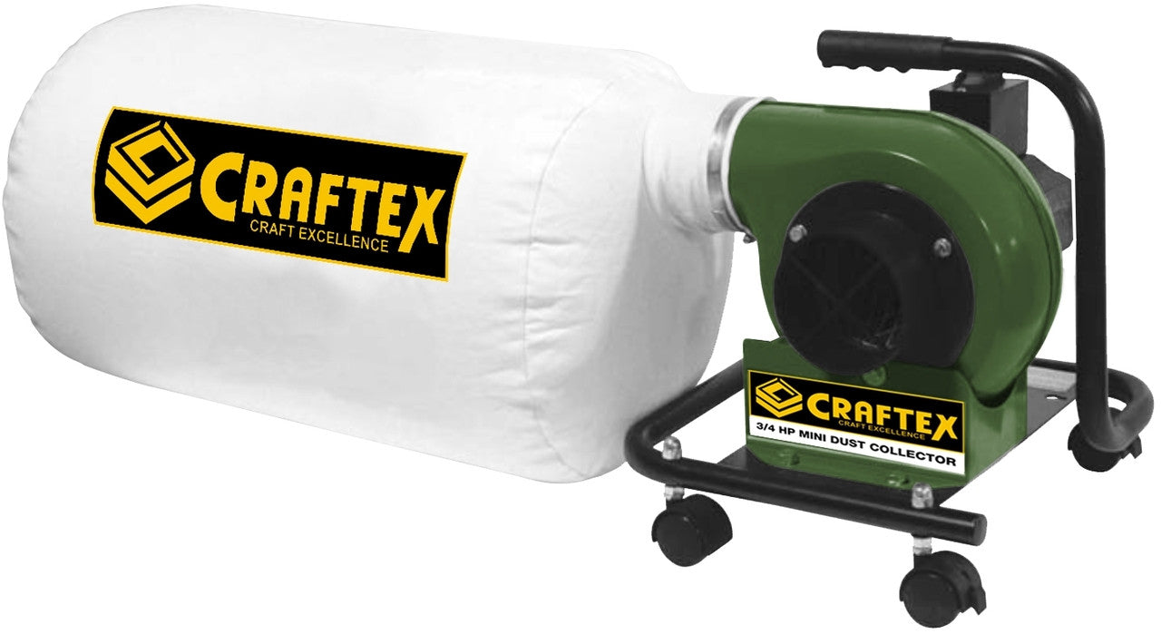

lilredex
Apr 29, 2006
5,956
Toronto
Think you are looking for something like this (shown) . Sold by many. I wouldn't put much hope into a central vac.
