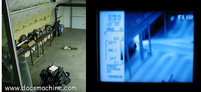

I've posted this before, but it's still fascinating:
Six years after initially posting these I just noticed in this shot that I ran one loop backwards, causing it to have a 3*F cooler exit than the rest of the loops!
You can use these cameras to see an impending heart attack(one half of the face will be cooler than the other), propane tank levels, watch people walk by on the other side of a wood slat fence, see if your TV remote is working, track people by their footprints, see what they touched 5 minutes later, look for loose electrical connections... One evening of borrowing this camera from work was not enough!
I didn't think direction of the loops mattered? I just stuck one end of each pex in each manifold? Do I need to rethink that? (Actually I doubt I have enough length to switch them).
The loops need to hit the perimeter first. You can see the lefthand edge is
colder than the area 2 feet farther in.
I did notice that entire corner lost its "dew" last upon initial warmup.
