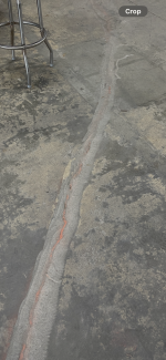

Get a concrete drill bit measure from the tip up 4 inch wrap tape around it so you have 4 inch sticking out
drill slowly - Don’t apply very much pressure if any. Let the drill bit do the work
once down about half way pay close attention to the concrete surface and the tape line, stop and vac or blow the concrete dust away if you can’t tell (eyeball ) 1/2, 3/4 or 1 inch stop and measure as you go
you will blow out the bottom about 1/2 or 3/4 inch from the bottom of the slab if you reach 3 1/2 deep with out blowing out the bottom, I’d say your good !
I’d use a 1/4, 3/8 inch roto hammer bit
you can always get a 1/2 inch thick metal plate and place between the top of concrete and the lift to spread out the load of the lift and car on top
as for patching I’d just get some concrete crack filler, mix it so it flows, and make 2 applications to make sure it’s topped off

I filled this crack w/ a sika floor leveler - 2 applications and then ground it flat to eliminate a trip hazard
the floor leveler had more glue to stick
