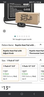

Harbor Freight imitation Pelican case and a reptile tank heating pad with thermostat. As they are foam lined you just pull out the precut foam cubes leaving a layer all the way around it and place batteries and thermostat and heat pad inside and clamp it shut. Protected from falls and freezing and cheap to run as they only draw 8 to 15 watts.

They make PTC cabinet heaters exactly for heating industrial electrical cabinets. The are available on 110v and there are small ones under 100 watts. Some have built in thermostats but many are controlled by an enclosure thermostat which are 35 bucks or so.
https://www.wolfautomation.com/heaters-mini-radiant-20w-100-250vac-1/
https://www.wolfautomation.com/thermostat-32-140-f-100-250vac-dc-30w-max/
They make even dual function enclosure thermostats that will engage a heater if to cold and turn on a fan of to warm.
