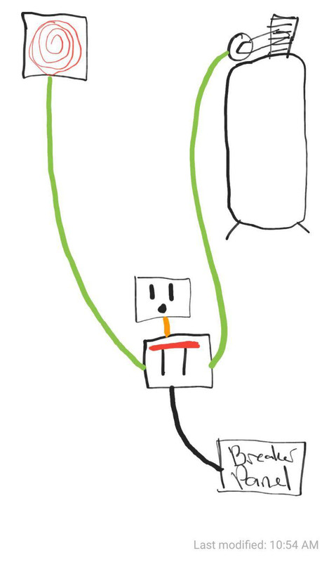

HI guys, I have a few questions regarding wiring a compressor, as well as a heater in my attached garage. My codes up here in Canada specify that an electric heater in a garage must be hard wired if used when someone is not working in the garage. That makes sense and I 100% agree with it. Now here is what I am trying to do and I don't know if I can.
I have currently wired a 50amp 240v plug into the garage. I want to hardwire my heater, as well as my compressor (7.5hp Baldor motor) to the same box that the plug is on, so I don't need to run 2 extra lines.
I am assuming I will need some sort of switch, so the compressor, heater and 50 amp plug can't be all operated at the same time, as they are only on a 50amp breaker. I also want to do all of this by code, but am not sure if any of this meets code. In my mind it should, as long as the 50amp circuit can not be overloaded by having all 3 items running at the same time.
I hope this makes some sense as I am typing and thinking at the same time haha. I could draw a diagram if that makes it any easier on anyone.
