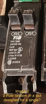

2) When I read the label on the tandem breaker in slot 1, it claims to be a 2-pole breaker? The breaker is a Thomas & Betts type TBBR and it lists "2 pole YF-6738" on the label. I attached a photo as Image 2. Both sides of this breaker feed separate 120V lighting and convenience outlet circuits in second floor bedrooms. If this is really a 2-pole breaker, I expected it to feed two hot legs to a 240V appliance or HVAC unit.

Tandem breakers can be fit into places they aren't supposed to go. It's really not that difficult, especially if they are not CTL. As far as the 240 for the AC, you have two breakers on two phases. On wire to each breaker will make 240. Is it right? Nope. Is it done? Yep. It should have a quad breaker in the proper part of the panel. Murray is no more, but I think Siemens breakers are listed to work in Murrays.
Bryant breakers fit, but aren't listed for use in a Murray panel. Those have become Eaton BR.

Those old Bryant's would fit about anything, anywhere. Just like the Eaton BR's of today as well as the Siemens non CTL. It's the Siemens CTL breakers that need to be modified to fit. (At least, that's what I've heard.)

Thank you Jim and Sparky. I'm home now, but I'll head back there in a day or two and pop the breakers off to see if they were modified. It's probably old enough that there wasn't a rejection tab in the way. You think a standard Siemens QP (ex. QP120) would work?

T&B breakers were UL classified for competitive panels, but have not been marketed in many years.

Based on the comments and after popping off the breakers as suggested to check the condition of everything, I bought a new Siemens 100A load center with more slots, got rid of the tandems and gave Mom some room for expansion.
That was a pretty simple swap. Wish I could have got her onto to some GFI breakers instead of using the outlets but with that old wiring scheme it was not in the cards.
