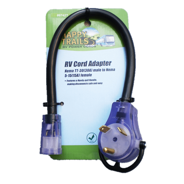

If you just want to use it as a normal outlet just get a converter that plugs into the outlet and has a normal 115volt outlet on the other end. Something like this:
Norcal
Mar 16, 2008
13,795
A 15A outlet on a 30A circuit is not a good idea and none of those adapters are listed either.

Like this flea gem. You can go the other way. A 50 to 20 not legal. A 50 to 30 is as it I'd designed for hooking to trailer that has further protection and the cord is 10 and can meet short circuit interuption.
Norcal
Mar 16, 2008
13,795
It’s still 15A with 30A overcurrent protection, no different then the one in post # 7.
jmiller_2308
Nov 16, 2013
577
Shakopee, MN
Hmm... I thought these things were fused but if not then yes, depending upon what you plugged into the adapter, if it drew more than 15A it would be a fire hazard.
Easy solution is to replace the 30A breaker with a 15A breaker and although if going to that much effort might want to just replace the receptacle as well.
Yes, meant to imply it was the same one. Thats what I meant by gem. I don't think it has any writing on it anywhere. Don't think it even says made in China. Could never figure out who to sue.
