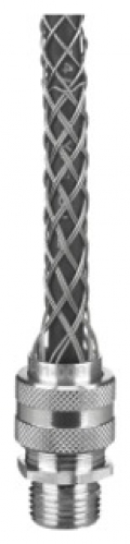

I would hang a simple cord before I added equipment. What's the point of the reel?
The reel was the suggestion of one of my wife’s EEs (she co-owns an engineering firm).
So, your suggestion is a twist lock receptacle mounted on the purlin with a twist lock cord hanging down? With this type of strain relief:
Or would you suggest a strain relief connector directly to the device box? Like this:
Either way, that's damn practical and a heck of a lot cheaper!

Let a couple others point out some how to but,,,, its wayyyyy cheaper, no moving parts to fuss over. I might use a common plug and a tie and then to a box mounted on the unit for extra 120V, might even use an equipment whip, the advantage of a plug is legal disconnect. If I really knew where it was gonna sit might even grove the floor, get rid of all the overhead.
As for EE, some are really great, some got to add every gadget they see. I like gadgets but,,,,,,,,,,,,,,, tended to use them more earlier in my career, it aint so above me to use some cords today and rely on the highly thought out system evolved with the use of cord and plug. I wanted to rewire some additional lights the other day, it was tempting to get the **** out and then I realize a couple lamp cords gave me every feature I needed. They are not hidden, they plug in, use the 2 way on one. So easy to use power strips for additional switch lights for some things. Good way to prove it out. If there is any recepts involved the circuits need to be limited to 20A.
My bud has a 4 post, he hook 25 ft 16 cord on to test it when he set up, been there for 30 yrs.
