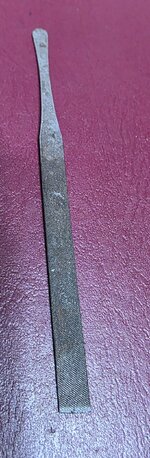

I found my grandpa's Cornwell open-end wrench set in a leather pouch today. My dad gave me his tool box a decade ago, but I had never looked at it closely until today. Grandpa worked at the Chrysler plant during WW2 and was an inspector for the plant, building Jeeps and Aircraft. If these tools could speak...
Does anyone have any information about these?

Ignition wrench set. Handy along with 1/4 socket sets for tune up work.

Thanks so much! That makes sense for the points. The entire tool box was handmade too. Super heavy, its full of old sockets and various sized hammers, and a socket wrench that looks like and old drill.

It has all the characteristics of an early- to mid-war 41-W-900 ignition wrench set. It had seven (7) wrenches. Six (6) of them, in pairs, from 13/64" to 5/16", with each end afforded a 15* and a 60* angle, and the seventh wrench was 11/32 (60*) by 3/8" (15*). The late war set added two additional wrenches (the other angles mate for the 11/32" x 3/8" wrench, and a 7/16 (15*) by 1/2" (60*) wrench), mini-pliers, and mini-screwdriver. And the roll-up was larger with more pockets to accommodate the additional tools. Wartime sets did not contain a points file, points adjuster, feeler gage etc., which were included in other related sets.
See page from a 1943 manual below.
30,853
Is the wrench without markings flipped over? Or just no markings? That could be the 13/64" (15*) x 15/64" (60*). You appear to be missing the largest (11/32"-15* x 3/8"-60*) wrench.
I collect ignition wrenches, especially wartime. I will look through my stash of orphans and see if I can help complete that set.
