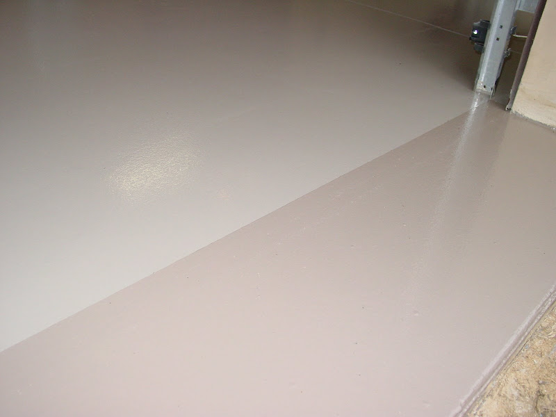

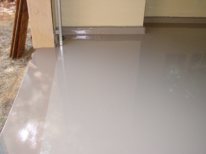

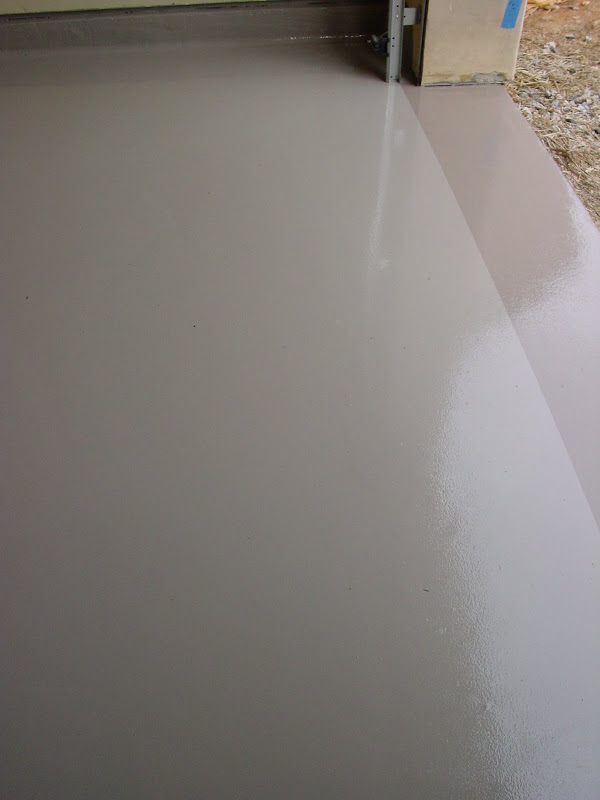

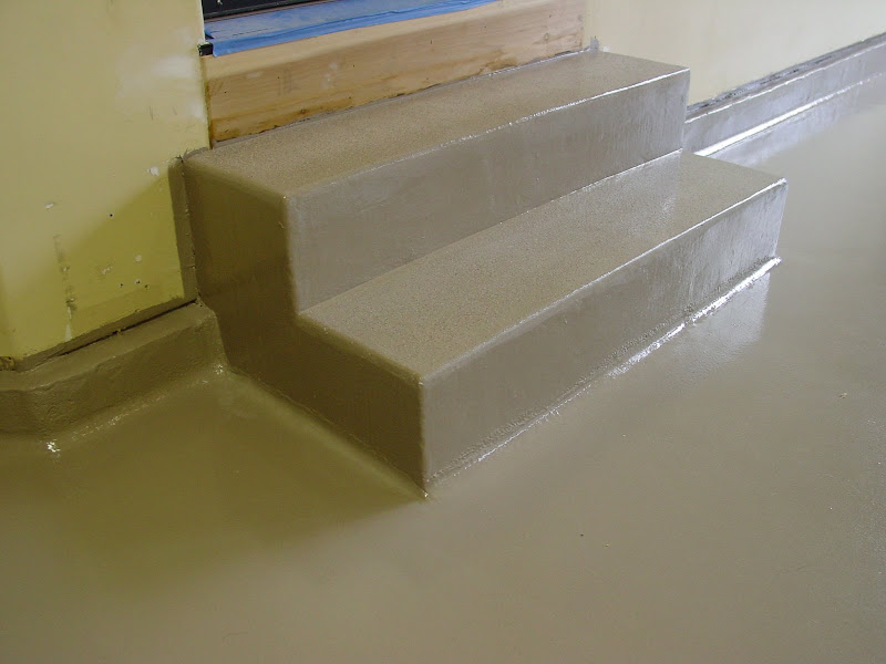

Some pictures from a recent installation. I used a mix of Sand Beige and Brown from Wolverine to make the colors.
The walls are scheduled to be repainted and the stucco redone, so I didn't worry too much about hitting them with epoxy.

Is it an illusion or shadow...........the epoxy looks different-darker on the concrete right outside the door
A
AmericanEpoxyFloors
May 8, 2009
42
Charlotte, NC
Yes, the front apron is a darker color. Its a tinted polyurethane. And yes, there is urethane on the floor as a topcoat. I think the topcoat is not on yet in some of the pictures, but I can't remember for sure.
