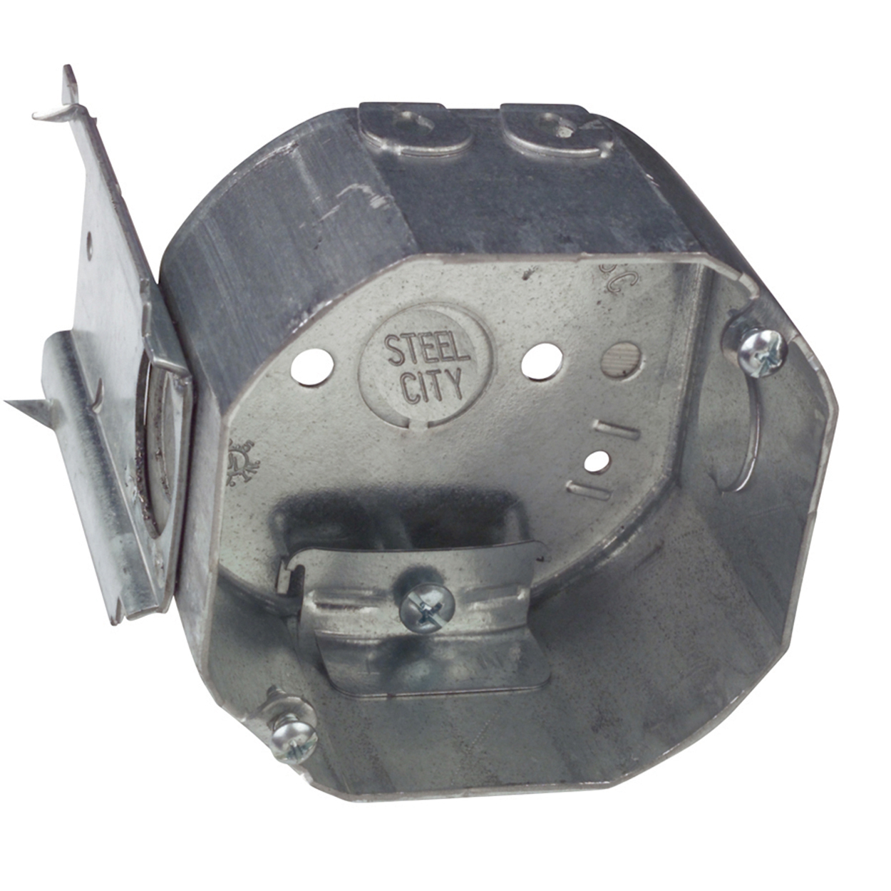

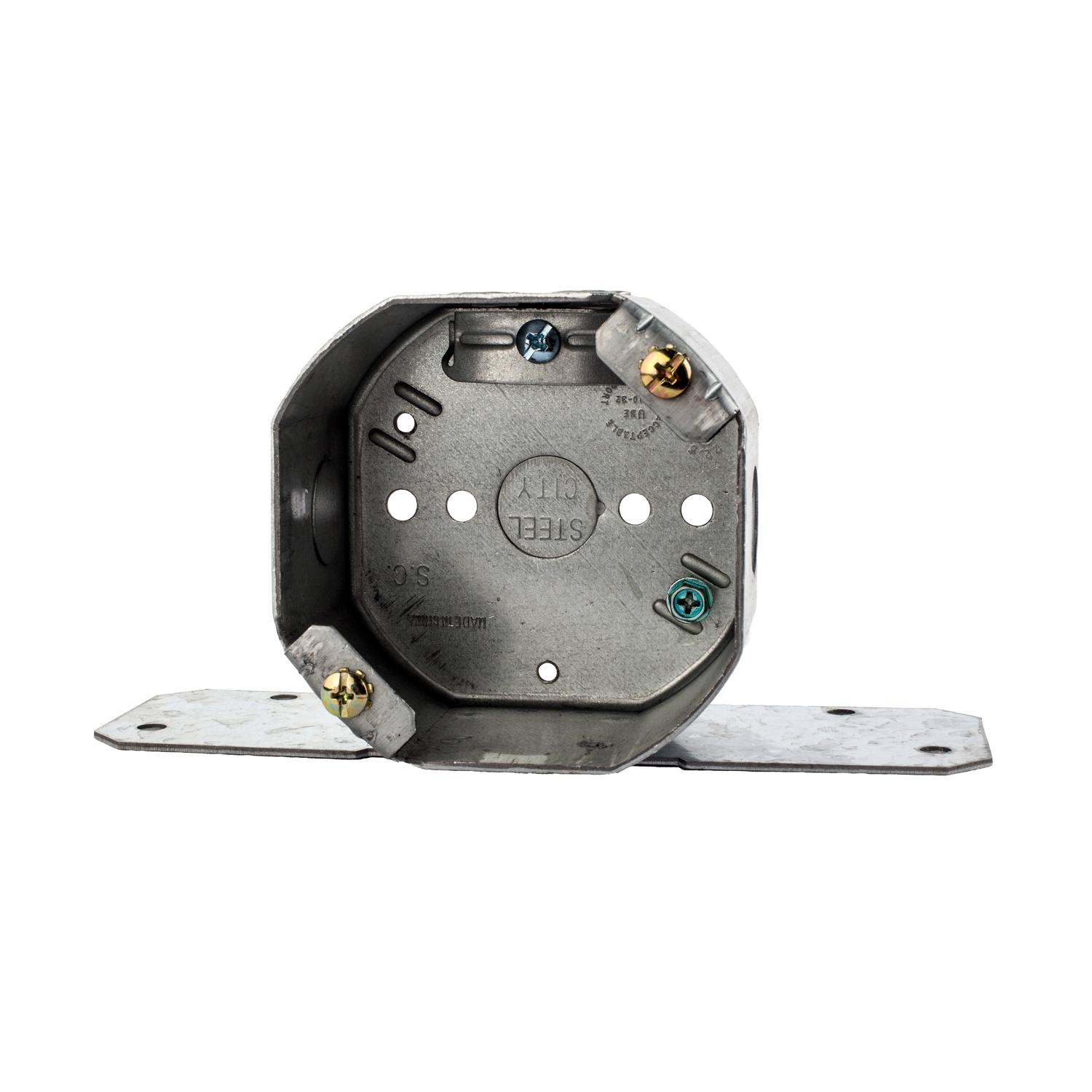

A pancake will be very full with even two 14-2's. I think if you go by box fill you are only allowed one. You can get by with it if your fixure has space in the canopy but those flush mount LED's have no space.
Just use a box with a side bracket and mount it to the side of the beam. They come in standard and fan rated.
