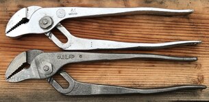

I found these last week. Dunlap pliers with circle Y. They are 6.5 inches long and have a coating that looks similar to cadmium.
Do we know who the Y in a circle manufacturer is?
3
12,060
Cool cool.
Pretty sure this came up over in a thread about pipe wrenches iirc. I think the maker is McKaig Hatch.
Some of their pliers have deep cut lines in the grip.
eBay example for comparison (not mine). This has the exact same same handle grip design as your pliers above.
29,774
^ that was exactly my thought as I posted that. that's why I went back and edited it and added the :dunno: guy and attached my copy of Gary Lauver's list there.
so.... IOW: we really don't have a clue who made "Circle-Y", correct? :headscrat
(at least until some more definitive evidence makes itself apparent.)

If we have McKaig-Hatch marked pliers and Dunlap marked pliers and both have the same handle designs, doesn't that imply that either McKaig-Hatch made these for Dunlap or someone else made them for both McKaig-Hatch and Dunlap?

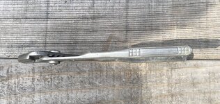

I looked more closely at the photos you sent and the handle pattern on the pliers is interesting, but it's not the pattern generally associated with McKaig-Hatch. If you check my page, McKaig pliers usually used a pattern with three parallel lines, then two chevrons, then three parallel lines. This pattern can be seen in a 50s era catalog at ITCL as well.
So to help establish McKaig-Hatch as the Circle Y makers, it would be very helpful if Dunlap pliers with the lines and chevron pattern could be found.

I took pictures of my groove joint Dunlap circle Y pliers yesterday. I’m hoping that the unique bolt may shed some light on the original supplier.

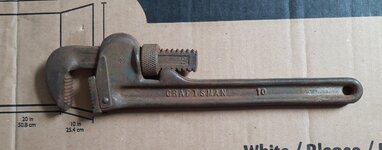

Thanks for your help, after reviewing the GJ threads and scouring catalogs and Ebay, I'm convinced that McKaig-Hatch was the Y-Circle maker. The "smoking gun" for me was the heavy-duty pipe wrench with a finger-grip handle, shown in the M-H catalog, Craftsman catalogs for '54 and '55, and currently available in an EBay listing.
AA
I am assuming the "current ebay listing" is the unit shown below:
