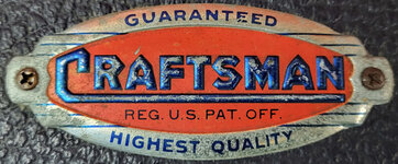

My set has the long-C badge on the box. I have seen other leather boxes on eBay or GJ with the heritage badge though. The inside of the lid also has a unique stylized long-C font. The description of the tools (on the inside of the lid) mentions they are vanadium.

As for the badge on the box: I saw a lathe for sale on FBMP that has the same badge (shape and color scheme).

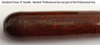

Beginning in 1940, the catalogs list the chisels as having 8" handles with 4" blades. They are described as having an average overall length of 13". (I know, the math doesn't work, but CM was consistent with this description.) In every ad in which the chisels appear, the ferrules are all even in the box, meaning the handles were all the same length. Measurements obtained from people who own these chisels confirmed the handles are 8" long. The handles were reddish-brown and may be marked "Craftsman Professional". (see pic below)
