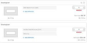

If I had the material, I would use a jig saw. If I had to buy materials, I would just order the part. You're looking at $9-14 +SH depending on material from sendcutsend. Free shipping if you can figure out a couple more parts to buy. 20ga is thin, like, condom thin. I'd suggest going thicker if you're going to mount anything like a radio in that DIN sized hole.
I attached a .txt file. Change the extension to .dxf if you want to use it on sendcutsend or send it to any other service provider (can't upload .dxf files here)
  • Drawing1.txt
