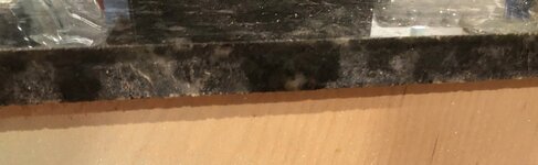

jar944
Jul 26, 2010
5,933
Northern VA
I would never, ever use a cheap circular saw, plugged into a GFCI, a diamond blade, a piece of 1/4" tube zip tied to the frame and hooked to a valve on a hose to trickle water on the cut.
That would be really dangerous.
If you move the slab outside you can skip the water.
