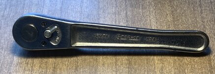

how about the F71M in 3/8? it doest have a V in the part number and no date on either....
I think if they are military the MV or M after the part number would make sense... for military version or not....
I probably overpaid, thinking they were much older, but the 1/4 is literally like new. the backing plate is also chrome, which I've never seen before. and the letting is raised, not stamped. you can tell me its from the 60's or 80's, but I would think a raised logo would be much older

The F71M is not military and you'll find in the cats. The M does not designate military it designates the revision level.
The MV71 is military. That is determined by the V.
It's not the design that made it military it was the contract between whatever government entity that issued the PO and SO. Those tools are not warranted. The original ratchets Snap-on made were very similar in design and were made for the civilian market into the 80's or 90's - maybe even later.
There are also round handled ratchets that are military like these - MV70 and MV70L

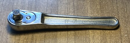

My father worked for Southern Airways, a helicopter school at Fort Wolters, outside Mineral Wells, Texas for years until the base closed. He had a 3/8 drive FV71 Snap-On ratchet in his rollaway for years. It was military issue and the on/off selector switch was missing. He still kept it all these years. After reading that SO would not warranty military issued tools makes sense why he never replaced it. I decided to order the RKRA380 kit and get it back in service. It works as smooth as butter. I imagine Daddy is smiling from heaven. :)Snapon 1.jpg
