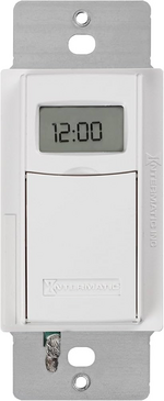

Intermatic still makes the ST01 and it's a top seller.
They started making the ST700 a few years ago and it's also a top seller. It even knows Spring ahead/fall back days. Click here for specs. If you want high tech, it comes in a wifi version that you can control with an app or set up a geo-fence.
Their latest product is the ABRA switch. It looks just like a regular decora switch, but it has a timer built into it, programmed via an app (very easy) and will respond to Alexa commands or other smart home devices. Click here for specs
You can order any intermatic device at your local electrical supply house.

I've had the ST01 above for over 15 years. I've only changed the battery once during that time. It cycles on off twice per day during that period.

We have 3 of the Intermatic ST01. The oldest is over 15 years just like @aandpdan has noted. Only 1 battery change. The others are 8 and 5 years old and have not changed batteries yet. My wife sets them up for sunrise/sunset timing when we install them and when we change the batteries and we never touch them again.

I have had up to 4 ST01's running in my place at one time or another. Batteries last a long time. A neutral wire is not required.
