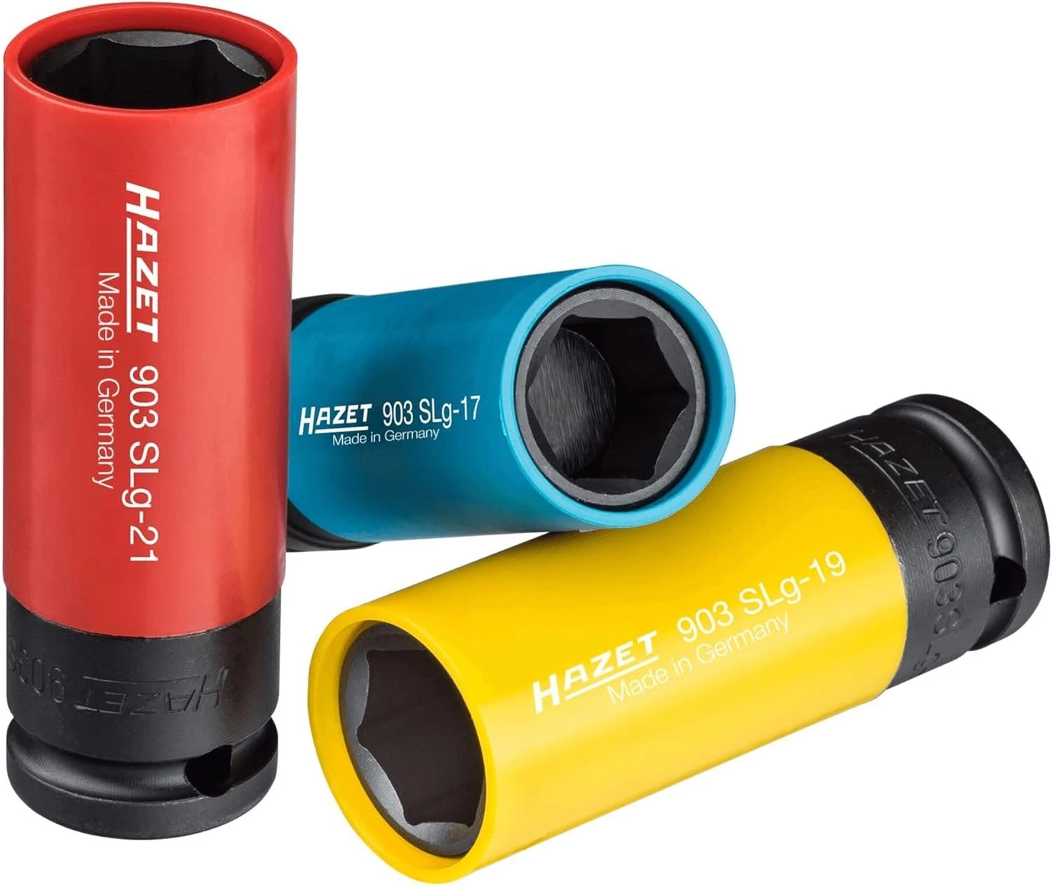

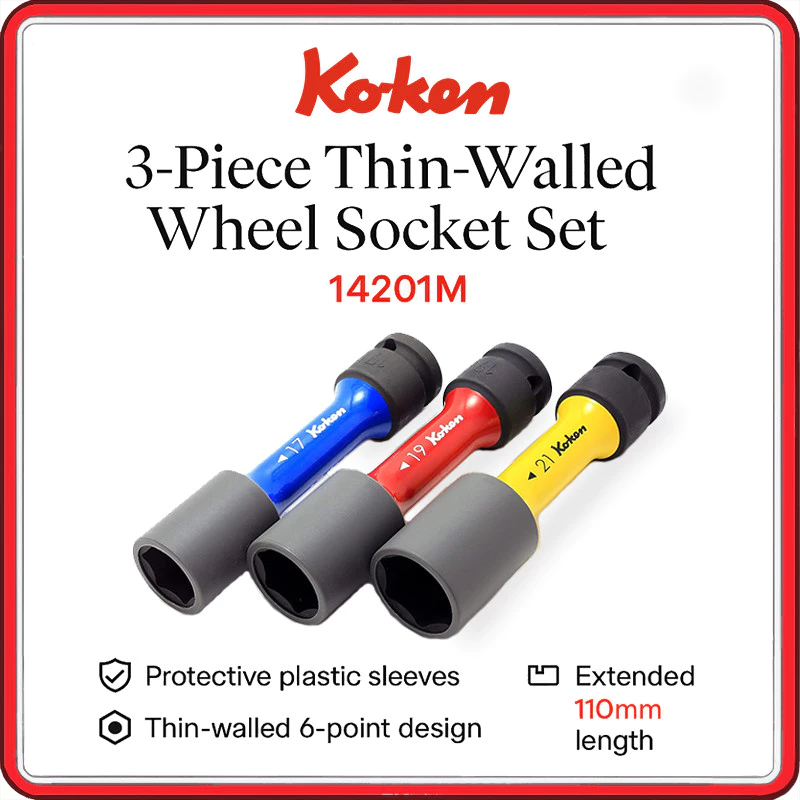

I have the Hazet 3pc set. Tossed them in the cardboard box of misfit tools immediately, likely never to be used again unless I need a sacrificial tool.
They are broached shallow to the point they damaged the lug nuts on a new vehicle. I suppose that depends on the lugs though.
I replaced them with the Ko-Ken and no longer have issues.
Just to associate numbers with this statement:
Depth of broaching on 19mm Hazet:
Depth of broaching on 19mm Ko-Ken:
L.Cheapo
Oct 23, 2014
5,946
Depth from flare to tip of lug nut where this causes a problem:
Length of hex on above lug nut:
So the Ko-Kens engage fully with the nut; the Hazets only engage the outer 10.38mm of the nut, which apparently isn't enough.

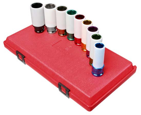

I picked up a new addition thanks to me reading this thread. Metric lug nut flip sockets with 1/2 sizes. Saw what looked to be this same set sold under several different brand names on Amazon. All seemed to have OK reviews. Just jumped on the one with the best price at the time after coupon applied. I suspect the size markings will not survive much use.

I have this set also. Zero complaints. Throw it and an impact and floor jack in the truck when pulling trailers and it makes a handy set.
