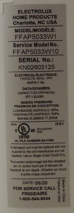

I see someone already mentioned Frigidaire (Electolux).
I have had very good luck with Frigidaire appliances in the last 25 years. We put in all new appliances using that brand in 2015. The fridge was a bit noisy, but one phone call and a service visit took care of that. Everything else has been quiet and trouble free.
I bought his 3 years ago for our "ping pong" room downstairs which is about 550 square feet. Even though it is only partially below grade, we were getting a LOT of moisture. This pulls out about 2 to 3 gallons a day. Have it set at 50 and it stays there. No more musty smell. Currently we just empty the bucket daily. It is a very clean, dust free space, so even though the air filter light comes on based on hours of use, I have never had to clean it. Always pull it off and take a look.
Plan is to run a hose through an exterior wall into a garden area so we don't have to mess with emptying it. But, given all my recent health issues (both shoulder joints replaced in 2020, two heart surgeries) and just getting old, I have not taken the time to do that yet. The exterior wall is 19.5 inches thick brick cavity construction from 1902. Also, I will have to run electrical for an outlet on that exterior wall, as there currently is not one, and I refuse to run an extension cord across the floor. Hopefully this fall. YMMV.
